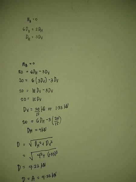

hey Thanks i got it now. here's my solution
A couple of suggestions so that other people can understand better what you are trying to communicate:
- put a ∑ sign in front of Ma and Mb so that it is clear that you are summing up the moments about point A and B respectively; otherwise someone may be thinking you are stating the moment reactions at A and B.
- make a statement that you are explicitly looking at member BD by itself e.g. "For member BD:" or better still draw a free body diagram right at this point.
- I think your sign convention might have been mixed up but you were consistent (or just lucky) so that it still gave the right answer at the end. I would state explicitly what sign convention you are using somewhere
e.g. "[itex]\rightarrow[/itex] -ve [itex]\uparrow[/itex] +ve"
which is what I think you used in your solution.
