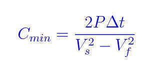

I`m really a beginner when it comes to designing electrical circuits and only have the ability to replicate cicuit designs. I have no idea how to choose and power up a capacitor the way I want it.
So what I need is a capacitor than I can charge up using a low voltage (around 5V) that can then supply with 20V with a device sucking up about 10A but only need to sustain it for 300µs.
Do I start with this equation?
In this equation though, isn`t the delta time the time it takes to charge it up? And is my Vs to be 5V or 0V?

If you draw constant current from a capacitor, the voltage drop linearly.
The basic capacitor equation you want is I = C dv/dt where dv is the change in voltage, dt is the time you discharge for, and I is the discharge current. Oh, and C is the capacitance.
For example, let's say it is OK to decay to 15V in the 300uS, and that I will remain constant at 10A (which isn't realistic since the voltage is dropping, but this gets us close in a simple way).
10A = C * 5V/300us so C = 10A * 300us/5V = 600uF
If you can only drop 2.5V, you need twice the capacitance.
Again, that is for constant current. If you are discharging into a constant resistance, then the equation is different since the current drain gets smaller as the voltage drops.
The voltage decay into a resistor is exponential, which you can read about here.
https://en.wikipedia.org/wiki/RC_circuit
Reverse the above equations to determine the charge times.
