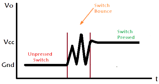

Except for the first few moments while the system equilibriates, there is no dichotomy. The rope is not over-stretched or under-stretched. It is stretched just right.
We do not usually care about the initial bouncing about and do not have enough information to calculate it anyway. So we settle for figuring out the equilibrium force after things have settled down.
Once again, switching to the electronics arena for an analogy. Switch bounce:
