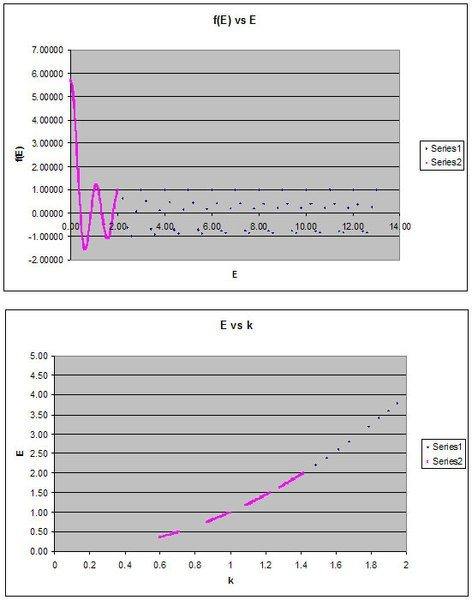

enaj
reproduce the kronig-penney E-k diagram (nothing more specific than that)
f([tex]\alpha*a[/tex])=P*SIN([tex]\alpha*a[/tex])/([tex]\alpha*a[/tex])+COS([tex]\alpha*a[/tex])
where P is the strength of the potential (I've assumed that it's 3[tex]\pi[/tex]/2)
and -1<=f([tex]\alpha*a[/tex])<=1
so far I've plotted f([tex]\alpha*a[/tex]), and as far as I can tell it looks right. But when I try to plot the allowed energy values from that graph against the k values, I get a graph that's a little too regular (though it does have band gaps) and it has no allowed states below ~k=0.6
I may be calculating k wrong. As I understand it, it's equal to the square root of the the energy from the graph of f([tex]\alpha*a[/tex]), since I'm using [tex]\alpha*a[/tex] as my variable, which is related to energy in the same way k is: [tex]\sqrt{ 2mE/\hbar^2}[/tex]
I've attached the graphs I have so far (the spreadsheet I used to calculate them is much too big).
Can anyone see where I might have gone wrong? I've replotted this many times and I can't seem to find it.
  • Two scatter plots: top, f(E) against E showing a damped oscillating magenta curve near E=0 that flattens into scattered blue points; bottom, E against k with blue and magenta points forming band segments rising from about 0.4 to 3.8.
My guess is that your software isn't capable of handling precision calculations. I'd recommend using another program, rather than OpenOffice/MS Excel.
As far as the graphs go, they look more or less right; though that non-existence of states below k=0.6 is a little strange--have you changed your value of P to see what effect that has on the graph?
