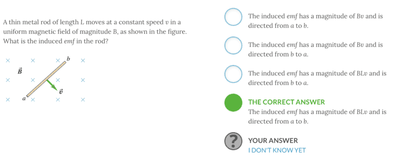

I understand the direction compnent of this question. But I don't understand where the magnitude of the induced current came from? I'm assuming faradays law wasn't used as there wasn't a change in magnetic field?
Look up "motional emf".
