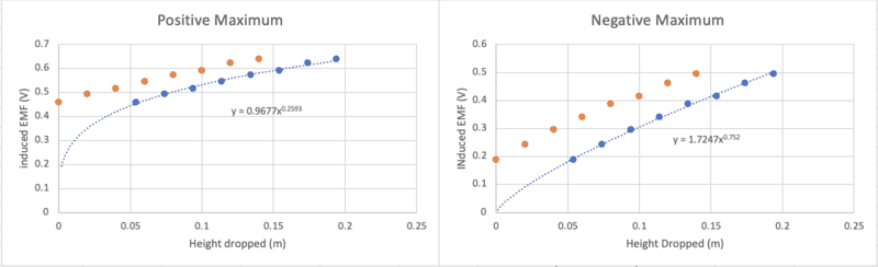

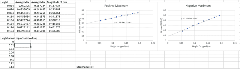

Attempting to determine a relationship between the height at which the magnet is dropped (relative to the centre of the solenoid) and the induced EMF in the solenoid.
## \varepsilon = -N \frac{d\Phi}{dt}## ##\Phi = B A \cos \theta ##
I am currently working on an experiment that involves dropping a magnet from varying heights and measuring how the induced emf of a solenoid changes as a result. I am currently somewhat struggling with a derivation for a relationship between the two variables, however, this is what I have been thinking about so far:
- Making assumptions to make things easier: magnet maintains constant acceleration throughout the solenoid (doesnt really slow down), Magnet remains upright throughout the fall, so that theta = 0.
- The solenoid experiences the greatest magnitude of emf when it is somewhere in between one of the ends of the solenoid and the middle, where it is 0.
I have collected data, and strangely, it yielded a linear graph of emf magnitude vs. height dropped.

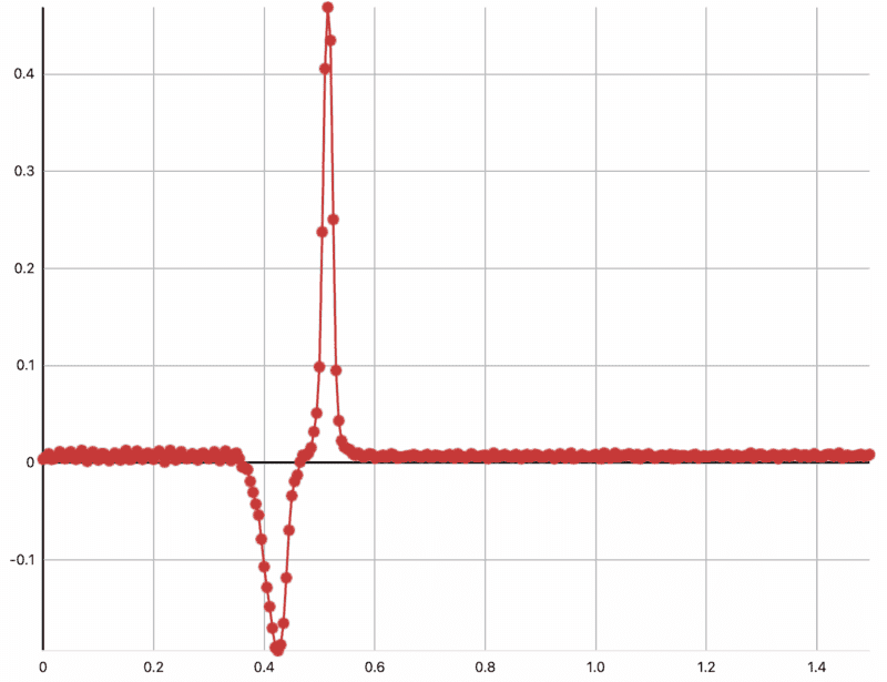

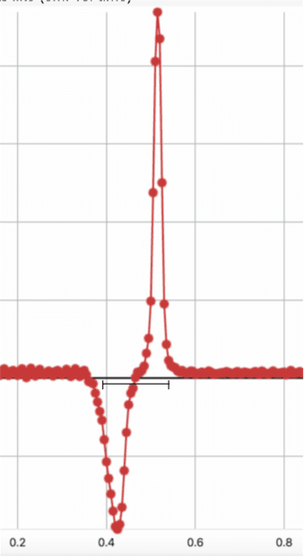

Here is also a graph of what one trial of dropping the magnet at 0cm above the top of solenoid (5.4cm above the centre) looks like (emf vs. time)
Thanks for any help!
The EMF at an instant will depend on the velocity of the magnet, the strength of the horizontal component of the field, and how much of the coil is engaged by the field. The horizontal component of the field reaches peak magnitude at two different places, but at the later position the velocity is greater.
If you suppose the horizontal component of the field reaches peak engagement with the coil when length x of the magnet is within the coil, can you deduce x from the positions of the peaks in the second graph?

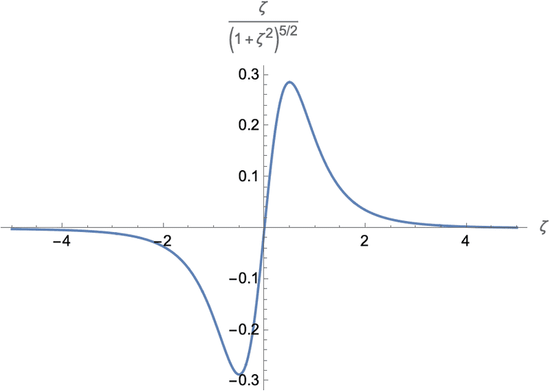

I once did a calculation for the induced emf when a dipole falls through a single loop. I was interested in finding an expression for the force on the magnet due to the induced magnetic dipole in the loop. I calculated the spatial profile of the emf to be $$\frac{d\Phi}{dt}=\frac{3\mu_0ma^2(z'-z)\dot z}{2[(z'-z)^2+a^2]^{5/2}}$$where
##m=## the moment of the point magnetic dipole
##a=## the radius of the loop
##z' = ## the position of the loop
##z = ## the position of the dipole.
I defined dimensionless parameter ##\zeta\equiv \dfrac{z'-z}{a}## which is the distance between the loop and the dipole in units of one loop radius and plotted omitting the constants. The plot is shown below.
I have defined dimensionless independent variable ##\zeta=\dfrac{z'-z}{a}## to do the plot. It is the distance between the loop and the falling dipole in unts of the radius ##a##. The plot shows that ##\frac{d\Phi}{dt}## starts becoming appreciable when the dipole is to within about 3 radii away from the loop.
All this is, of course, an idealization because the data for this study were collected using a permanent magnet of finite extent, not a point dipole which doesn't exist. Nevertheless, I think it is fair to say that when the magnet is dropped through a solenoid, only the loops that are "in range" are engaged.

I'm not convinced the retardation of the magnet will be that significant. If there is no circuit, how does conservation of work operate here?
A more obvious concern is the claimed linear fit of peak voltage against height dropped. In a crude model - single loop of coil, only engaged as the most effective part of the field moves through it - one would expect (retardation apart) the peak velocity to vary as the square root of the height dropped. Of course, that gets smeared as we allow for multiple loops to be engaged by multiple parts of the field simultaneously.
Indeed, the right hand graph in post #1 does give a hint of a declining gradient.

I tried to estimate if there is retardation in @billyt_'s setup as follows. We are told that
If the magnet were in free fall without retardation over the length of twice the distance to the centre (= 10.8 cm), the time of flight would be (to 2 sig figs) $$t_{\!f}=\sqrt{\frac{2h}{g}}=\sqrt{\frac{2\times 0.108~\text{m}}{9.8~\text{m/s}^2}}=0.15~\text{s}.$$
In the figure below I have superimposed the 0.15 s interval assuming that the vertical gridline labels are in seconds. I think it is clear that it takes longer than 0.15 s for the magnet to drop through the solenoid. It's not much, but it's there.

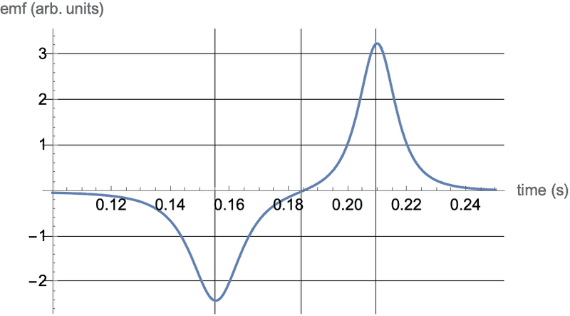

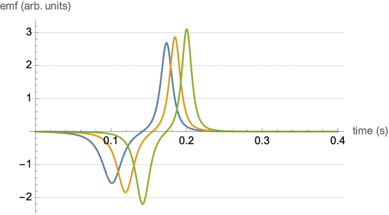

I think I have an equation that reproduces the features of the graph posted by OP. I considered a point dipole falling through a solenoid of ##N## turns, length ##L## and radius ##a##. I put the origin of coordinates at ##\frac{L}{2}## and assumed that the dipole is dropped through the solenoid starting from rest at position ##h+\frac{l}{2}.## I used the kinematic equation ##z(t)=h+\frac{L}{2}-\frac{1}{2}gt^2## for the position of the dipole on the ##z##-axis. Then
I calculated the magnetic flux through a circle of radius ##a## at position ##z'## when the dipole is at ##z## using ##\Phi=\int \mathbf{B}_{dipole} \cdot \mathbf{\hat n}~dA## to get $$\Phi ( z')=\frac{ \mu _0 m a^2}{2 \left[a^2+(z'-z) ^2\right]^{3/2}}$$where ##a## is the radius of the solenoid, and ##m## the dipole moment. This gives $$\frac{\text{d$\Phi $}}{\text{dt}}=\frac{3 \mu _0 m a^2 (z'-z) ~ \dot{z}}{2 \left[a^2+(z'-z)^2\right]^{5/2}}.$$ Now a stack of solenoid loops of height ##dz'## contains ##\frac{N}{L}dz'## loops so that the emf at the ends of the stack is $$d(\text{emf})=\frac{N}{L}\frac{3 \mu _0 m a^2 (z'-z) ~ \dot{z}}{2 \left[a^2+(z'-z)^2\right]^{5/2}}dz'.$$We add all the contributions to get the emf at the two ends of the solenoid, $$\text{emf}=\frac{3N\mu_0ma^2~\dot z}{2L}\int_{L/2}^{-L/2}\frac{ (z'-z) }{ \left[a^2+(z'-z)^2\right]^{5/2}}dz'.$$ With ##z(t)## as assumed above, the integral yields $$\text{emf} (t)
=\frac{4N \mu _0 m a^2 g}{L} \left[\frac{t}{\left(4 a^2+\left(2 (h+L)-g t^2\right)^2\right)^{3/2}}-\frac{t}{\left(4 a^2+\left(2 h-g t^2\right)^2\right)^{3/2}}\right]$$Of course what counts is the expression in the square brackets as the product of constants up front is just a scaling parameter. I chose realistic values as best as I could ascertain from the OP, L = 0.1 m, a = 0.02 m. The latter was a guess that made the plots look like the one posted by the OP. Below are the plots for 3 values of h = 0.5 m (blue), 0.7 m (orange) and 0.1 m (green).
There is qualitative agreement with the experimental results:
  • In each plot the negative peaks are fatter and shorter than the positive peaks.
  • The peaks increase as the height from which the dipole is dropped is increased.
  • There is a hint of a plateau at the inflection point.
  • The overall signal spans approximately the same time interval of about 0.2 s as the data.

kuruman said:
0.1 m (green).
Did you mean 1.0m? Or should the others be 0.05m, 0.07m?
In this analysis, there is no retardation, right?
The next step would be to model the first pair of charts, finding how peak emf depends on drop height. Working from your equation, I got up to terms of order ##t^{32}## before giving up.

Success! First I replotted emf(t) vs t with vertical gridlines added at the times when the dipole crosses the top, the middle and the end of the solenoid. I was thrilled to see the plot below which makes great sense in retrospect.

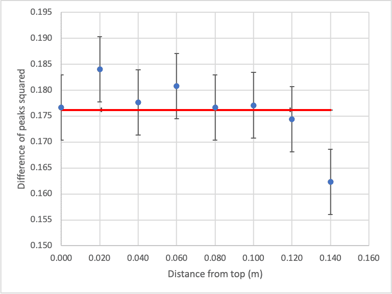

If we consider a sphere of radius about one solenoid diameter centered at the dipole, the flux will change most rapidly when the sphere is halfway in the top or halfway out the bottom and hardly at all in the middle. Thus, the peak extrema occur at the times when the dipole enters and exits the solenoid. The times are ##t_1=\sqrt{\frac{2h}{g}}## and ##t_2=\sqrt{\frac{2(h+L)}{g}}.## These can be substituted in the equation to find the extrema
$$\begin{align} & P_1=\text{emf} (t_1)=\frac{4N \mu _0 m a^2 g}{L} \frac{1}{4} \sqrt{\frac{h}{2 g}} \left(\frac{1}{\left(a^2+L^2\right)^{3/2}}-\frac{1}{a^3}\right)=K \sqrt{h} \nonumber \\ & P_2=\text{emf} (t_2)=\frac{4N \mu _0 m a^2 g}{L} \frac{1}{4} \sqrt{\frac{h+L}{2 g}} \left(\frac{1}{\left(a^2+L^2\right)^{3/2}}-\frac{1}{a^3}\right)=K\sqrt{h+L}\nonumber \end{align}$$It follows that $$P_2^2-P_1^2=\text{const.}$$which is testable hypothesis. The plot below shows the difference of the squares of the peaks plotted against the dropping height ##h## (discrete points). The red line is the average of the data. Lacking experimental uncertainty information, I added error bars as ± one standard deviation. Except for one outlier, it looks like the data support the theory.

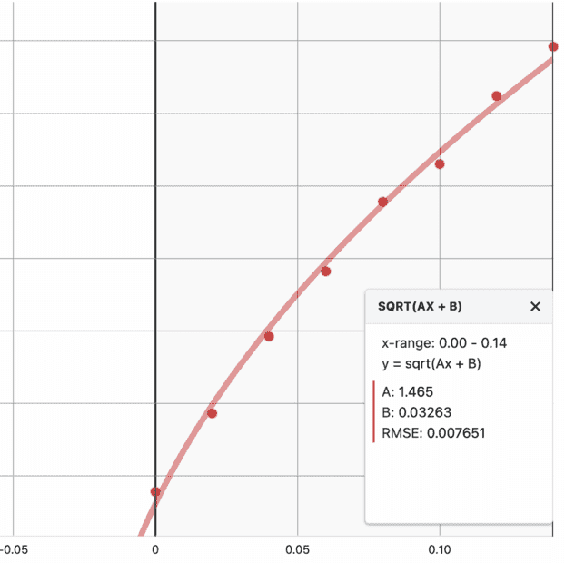

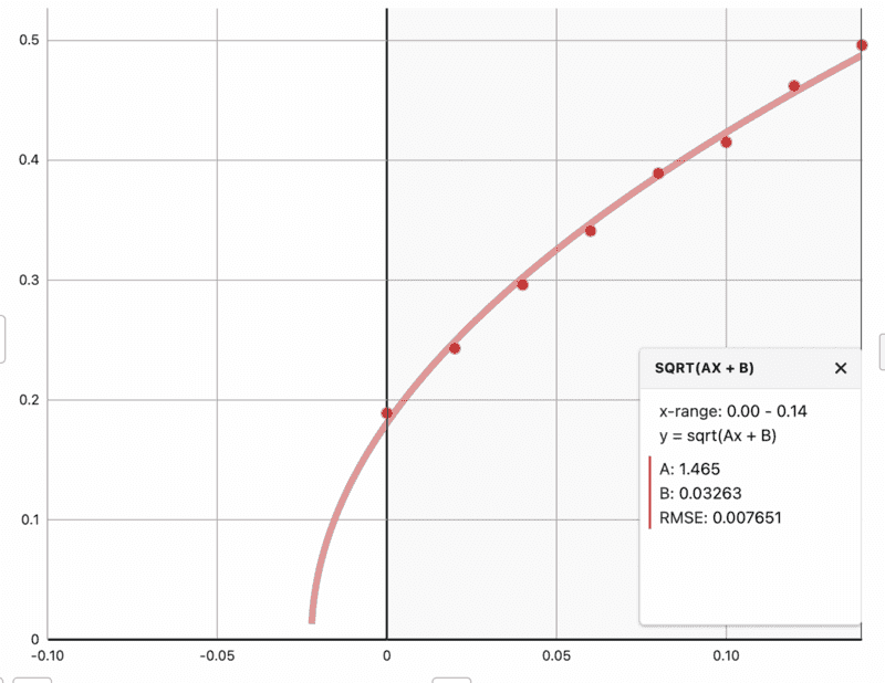

Ok, so your more complete model supports the ##\sqrt h## relationship I had for the single coil model in post #6. But it is unclear how to map the h in your model to that used in the plots in post #1.
I had thought we should be able to find a constant adjustment that would give a reasonable fit to the graphs, E.g. take the best straight line fits to ##V^2## against h and see where they intercept the X axis. But the plots in post #1 look worryingly straight already, so I feel we would need to abandon the dipole model to get a more realistic answer. It gets complicated because we would need a model for the shape of the field lines from a bar magnet. We might also need to consider the (unknown) gap between magnet and solenoid.

I have been trying to explain why the first two graphs in post #1 look so straight, rather than as parabolas centred on the x axis. I suspect it is to do with the fact that this is a solenoid, not just one loop.
If the magnet were to pass through at constant velocity then the peak magnitudes would appear at a certain pair of depths. Since it is accelerating, the peaks will be a little delayed. Since the velocity should rise as the sqrt of the height descended, the delay (in terms of height at which it occurs) will be greater for the shorter drop heights (lower velocities). That will increase the peak voltages at low drop heights in comparison to the peak voltages at greater drop heights.
Maybe that is enough to explain the flattening.

It is interesting, as just from some simple graphical analysis, it appears that the function of negative magnitude vs. height looks a lot closer to a ##y = \sqrt{x}## function than the positive magnitude.
Using the experimental data, if we try to plot it as a power function on excel, the equations below can be seen, although the positive maximum graph is quite clearly pushing it a bit. Also note that error bars can't really fix this as the experimental uncertainty I obtained is all less than 0.01 Volts.

You must not assume it starts at the origin of your coordinates. You do not know what the 'effective' drop height is. Find the best fit of the form ##y^2=Ax+B##, for each separately.
