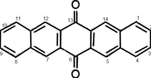

What do the indices 6 and 13 stand for in 6,13-pentacenequinone?
I know that is related to the position of the substituents in the molecule, but I cannot figure out how to interpret it.
Can some one point me to a reference where the basics the nomenclature are explained?

We didn't cover things like this in O chem, but I can make a slightly educated guess, in hopes that someone more knowledgeable will come along.
Edit: I did a bit more research and got it. The carbons are numbered atypically. Oh well, that's typical IUPAC for you, I suppose.
The picture is now correct, showing that carbon 6 and carbon 13 are the ones with the oxygens attached.

Thanks! Now it is clear.
