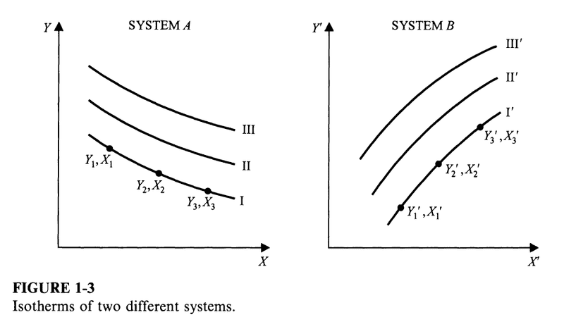

Thermal equilibrium
is the state achieved by two (or more) systems, characterized by restricted values of the coordinates of the systems, after they have been in communication with each other through a diathermic wall.
An isotherm is the locus of all points representing states in which a system is in thermal equilibrium with one specific state of another system (and also in equilibrium with all other points on the isotherm itself).
Corresponding isotherms are isotherms of two different systems that represent states of thermal equilibrium between the systems.
Here is an example:
In this example, the three following states of system B, ##(Y_1', X_1')##, ##(Y_2', X_2')##, and ##(Y_3', X_3')## are all in thermal equilibrium with each other, and all are in thermal equilibrium with each of ##(Y_1, X_1)##, ##(Y_2, X_2)##, and ##(Y_3, X_3)## of system A. Indeed any point on the corresponding isotherm of system B is in thermal equilibrium with the corresponding isotherm of system A.

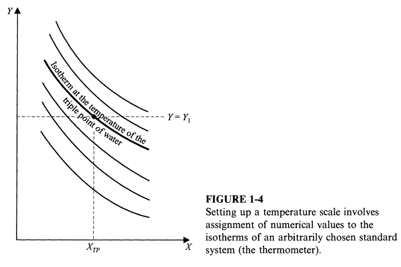

A thermometer is some specific system with thermodynamic coordinates X and Y that we designate the standard system plus a set of rules for assigning a temperature to that system's isotherms. To every system in thermal equilibrium with a specified thermometer at some specific coordinates, we assign the same temperature as assigned to the thermometer's isotherm at those specific coordinates.
One way (perhaps the simplest) to make the assignment of values to the isotherms is to fix one thermodynamic coordinate (Y) and vary the other one (X). The temperature of an isotherm is then some function ##\theta(X)##.
Coordinate ##X## is called the thermometric property and ##\theta(X)## is the thermometric function.
Here is an example
The thermometric function is also what we call an empirical temperature scale.

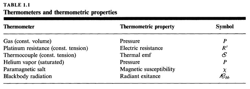

There are many different kinds of thermometer, each with its own thermometric property. Here is a table with six modern thermometers and their thermometric properties.
Now, let's choose one of the thermometric properties in the table above and call it X and let's define ##\theta## as a constant times X. That is ##\theta(X)=aX## where ##a## is a constant. Note that ##Y## is held constant.

The next step in this whole reasoning is to choose that third system in a very specific way, ie choose a standard reference system in a specific reproducible state that we call a fixed point, ie a fixed temperature.
The fixed point is a reference temperature for the determination of temperature scales.
I now explain why this is by using a real-world example.
In 1954, a single fixed point was chosen as the basis for a new international temperature scale, the Kelvin scale. This chosen fixed point is the triple point of water.
From what I understand, there is only a single value of pressure and a single value of temperature at which the triple point occurs. The pressure is the partial vapor pressure of the gaseous water at 611.657 Pa. (This part is still not too clear for me, because I have trouble with the part about this being true regardless of the volume of water.)
However, the type of water in this reference system is also specified in detail (for example, the proportion of isotopes of hydrogen and oxygen).
So, for a system with this specific type of water at the pressure of 611.657 Pa and at triple point, the temperature was assigned a value, 273.16K.
By assigning this value we have, ##\theta(P_{TP})=273.16=aX_{TP}##.
Thus, for any thermometric property of our choosing we can measure its value at the triple point of water (for whatever thermometer we are using), and then we can solve for ##a##.
$$a=\frac{273.16}{X_{TP}}$$
Hence, for all thermometers that assign the temperature 273.16K to the triple point, we have the relationship
$$\theta(X)=273.16\frac{X}{X_{TP}}$$

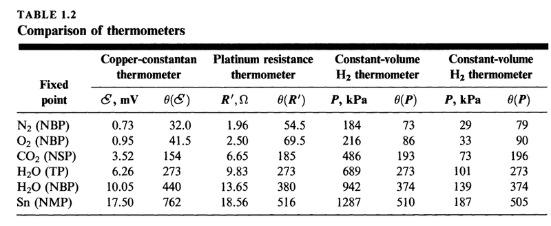

My second question is about the following table
NBP = normal boiling point
NMP = normal melting point
NSP = normal sublimation point
TP = triple point
What we have here is three different thermometers (in the columns) and six different thermodynamic states (rows). Note that in the last four columns we have the same thermometer, hydrogen gas at a specific constant volume, but used in one case at high pressure and in one case at low pressure. My doubt is about this distinction, and I'll get to this further below.
The numerical values are not meant to be exact and 273.16 has been written as 273.
Just to be clear, as an example, if we take the platinum wire resistor thermometer, which uses resistance as the thermometric property, we have
$$\theta(R')=273.16\frac{R'}{R_{TP}'}$$
My question is about the two constant-volume ##H_2## thermometers.
What does it mean that one is at high pressure and the other is at low pressure?
Here is what I think this means
If the volume of one constant-volume thermometer is larger than the other, then the pressure at the triple point will be relatively smaller, as we see in the table. In fact, at any temperature, the pressure will be smaller than the constant-volume thermometer with the smaller volume.
Is this correct?
