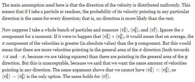

Herman Trivilino said:
It's the first sentence in the passage you quoted:
"The main assumption here is that the direction of the velocity is distributed uniformly."
It's not enough.

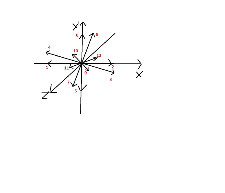

Mike_bb said:
Hi all!
In the book there was following expression:
##N\frac{mc_x^2}{2} = \frac{N}{3} \frac{mc^2}{2}##
##c^2 = 3с_x^2##
Explanation: 1/3 of all particles moves along one axis (in both directions).
I depicted 12 particles and their velocities. But I don't understand which 4 molecules move along one axis.
Could anyone explain it?
Thanks.

Looking at your drawing here, those numbers are quite wrong. Where are you getting them?
As I read the drawing, ##v_{1x}## is negative, ##v_{2x}## is positive, ##v_{3x}## is positive and ##v_{4x}## is negative. ##N## is 12 for that situation.

Mike_bb said:
Is this true?
Technically the quoted passage is false. It is an argument, not a valid proof.
The first error is minor. The author says that if the mean of ##{v_x}^2## is greater than the mean of ##{v_y}^2## that means that the x component of the velocities is greater in absolute value than the y component. As a handwave, that claim is arguably true. However, as a statement of mathematical fact, it is wrong. It is wrong because taking the absolute value is not the same thing as taking the square. The two functions are shaped similarly, but not identically. One can exploit this to construct counter-examples.
The second error is more fundamental. Let us reduce the problem to two dimensions as the author has done. We begin with an array of velocities that are uniformly distributed in direction. Suppose that these velocities are also uniformly(*) distributed in magnitude. There is no general direction such that velocities in that direction have a larger magnitude than tuples in the orthogonal direction.
Now let us modify this array of velocities in the following way...
For every velocity that is generally in the ##x## direction we double its magnitude. For every velocity that is generally in the ##y## direction we halve its magnitude.
I claim that the distribution of directions in the resulting array is still uniform. Yet the average squared velocity in the ##x## direction will be larger than the average squared velocity in the ##y## direction.
This illustrates the point that having a uniform distribution of directions is not sufficient to make a velocity distribution isotropic.
(*) There is no such thing as a uniform distribution over the range ##[ 0, \infty )## so technically my objection is not entirely rigorous. But, like the author's passage, it is close enough to provide the flavor for a technically correct argument.
But isn't the author arguing that having a uniform distribution of velocities is sufficient to make a uniform distribution of directions?
That may be the idea that he is pursuing. But the argument he made does not use the premise that the velocities are uniformly distributed. Only that their directions are uniformly distributed. That premise is insufficient for the desired conclusion.

If you have one particle, the components of the velocity vector at some chosen time are not isotropic. The particle is [almost certainly] moving in some direction. Its [squared] velocity in that direction is non-zero. Its [squared] velocity in the two orthogonal directions is zero. That is not isotropic.
[To be fair, if we are working in the center of momentum frame, the one particle case is rather degenerate. The particle has zero velocity. There is no randomness in play at all]
If you have two particles, you again cannot have isotropy. There is a some plane within which the two velocity vectors will lie. The sum of the squared velocities in the direction orthogonal to the plane will be zero. The sum of the squared velocities in the two orthogonal directions will be non-zero. That is not isotropic.
[Again, if we were playing fair, using the center of momentum frame and demanding zero total angular momentum then the two particles would be moving toward or away from each other on a common line rather than a common plane]
If you have three particles, you again cannot have isotropy. Pick almost any orthogonal triple of directions. The sum of the squared velocities in the three directions will differ from one another due to random variation.
If you have a large number of particles, the law of large numbers makes itself evident. The sum of squared velocities in any three orthogonal directions will be in remarkably good agreement with each other.
