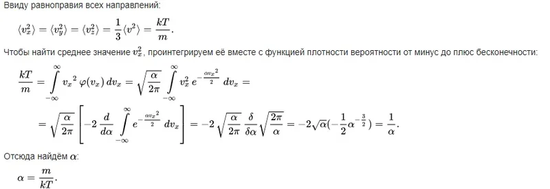

jbriggs444 said:
But what are you integrating over?
I'm integrating over continuous distribution. (components of velocities on X-axis)
The result is ##\frac{kT}{m}##. This result coincide with ##<V_x^2>## (finite large sample). How is it possible?
jbriggs444,
Am I right that for every particle with positive component on X-axis we can find particle with opposite (negative) component? If it's so then I really understand how it works.
Google AI:
How is it possible? Why should it not be possible? Why the surprise?
It is very difficult to respond to an open ended question like this. You need to be specific about your concerns. Or, as has been aptly suggested, use a textbook and take a course.

Mike_bb said:
Not long ago I took my old school book to repeat and it was written there that ##<V_x^2> = <V_y^2> = <V_z^2>## because X-axis, Y-axis and Z-axis are equiprobable.
It may be a language issue, but "equiprobable" is not the correct term to use.
If ##V_x## is a random variable then we could speak of the probability that ##V_x## falls within a particular range. We could speak of the probability that ##V_y## falls within the same range. Or ##V_z##.
If the coordinate velocities are independent and identically distributed then those three events (that the random variables fall into a particular range) would be equiprobable. The converse does not hold.
The premise that the book should be using is that ##V_x##, ##V_y## and ##V_z## are "independent and identically distributed". Not that they are "equiprobable". From that starting point, it is trivially true that any statistical measure (such as mean square) of one distribution will be identical to the same statistical measure of any other identical distribution.
This is all before we get into a discussion about the distinction between the expected value for a distribution and the mean of a particular sample.
jbriggs444 said:
The premise that the book should be using is that Vx, Vy and Vz are "independent and identically distributed". Not that they are "equiprobable".
But the book is written in Russian, so it seems it hasn't been translated correctly?
Likely the translation algorithm is for everyday terminology, not technical jargon. Who knows?
