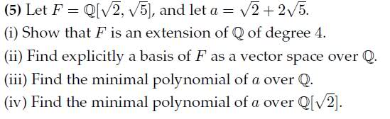

Printed exercise (5) on field theory: let F = Q(sqrt2, sqrt5) and a = sqrt2 + 2sqrt5; parts (i) show F is an extension of Q of degree 4, (ii) find a basis of F over Q, (iii) minimal polynomial of a over Q, (iv) minimal polynomial of a over Q(sqrt2).
Wouldn't mind a hint on how to start part iii), thanks.
edit: in my notes i have for a similar question:
'L=Q(20.5, 30.5)
F=Q(60.5)
degree of the min polynomial = 2, because L=F(a) and [L:F]=2
' (a = alpha)
Could someone clarify what L=F(a) means so I can understand the example? Thanks
I have found an example of how to do it here:
http://www.math.niu.edu/~beachy/abstract_algebra/study_guide/soln6.html
Though, can someone explain to me on their example of the last line to the solution of 2.b) as to why they chose
u -i = 20.5
and not
u - 20.5 = i
or does it not matter as both give you a poly of degree 4?
The answer to the question in your second post is that you may use either expression for the reason you gave ("... both give you a poly of degree 4"). In fact, they give you the same poly. Does that clear up your original question?

Do they give the same poly?
If I do it that way I get
u - 20.5 = i
u2 - 2u20.5 - 2 = -1
u2 - 1 = 2u20.5
u4 - 2u2 + 1 = 8u2
u4 - 10u2 + 1 = 0
and their answer was
u4 - 2u2 + 9 = 0
Hence I have two different polynomials for the question I'm trying to do, both degree 4 and monic and I'm not sure which to choose.
In your calculation, this step
is incorrect. Do you see why?
