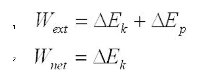

State the work-energy theorem.
see below
My research leads to 2 slightly different equations. See equations 1 and 2 attached.
Also, for equation 1 should Wext be Wnet ext ?
Two equations, numbered 1 and 2: W_ext = ΔE_k + ΔE_p, and W_net = ΔE_k, with subscripts ext, net, k and p.

Does your 'research' (any references ?) also have a context explaining what is meant with each of these variables ?
W ext = work done by external forces.
Ek = kinetic energy
Ep - potential energy
W net = net work

Remarkable that one can achieve a PhD in physics without knowing the work-energy theorem, isn't it . . . !
I do know, however, the terms and the equations (my question was an in vitation to you to think about what the symbols represent), so I still feel qualified to help.
Both your number 1 and number 2 are good candiates -- as your research shows. Since it's only a label, the homework statement would be better in place in an english class than in physics as far as I'm concerned. The physics point is that one understands what needs to be considered in a particular situation (hence my question about context: what is considered 'the system' determines what is internal and what is external. The presence or absence of of a conservative force field determines if mechanical energy conservation is expressed as nr 1 or as nr 2).
As a physicist I prefer number 1, but I see number 2 popping up quite often as well -- in the implicitly or explicitly mentioned context of the absence of a gravitational field.
The answer to your
is a lot easier: yes!

it is a very frequent mistake: to take into account only the external forces in the work energy theorem. Actually the notion external\ internal is not relevant here
Perhaps it would be useful to formulate the work energy theorem here.
Assume we have a system of particles ##m_1,\ldots,m_N## with position vectors ##r_1,\ldots,r_N## relative an inertial frame. A net force that the particle ##m_i## experiences is presented as follows
$$F_i-\frac{\partial V}{\partial r_i},\quad V=V(r_1,\ldots,r_N).$$
And $$T=\frac{1}{2}\sum_{i=1}^Nm_i|\dot r_i|^2.$$
Theorem:
$$\frac{d}{dt}(T+V)= \sum_{i=1}^N (F_i,\dot r_i).$$

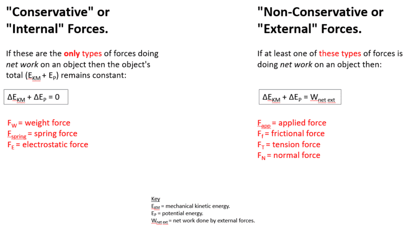

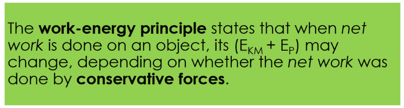

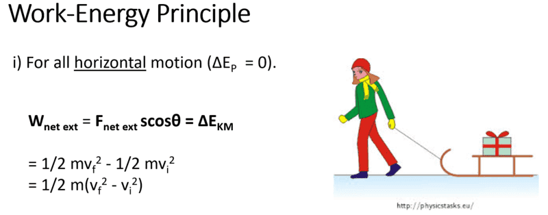

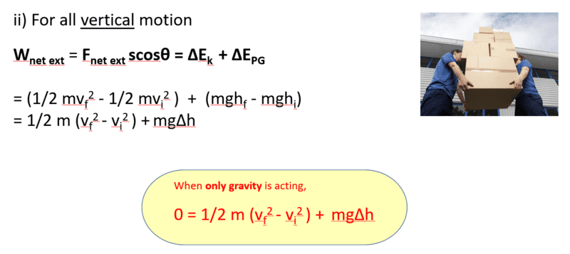

OK so here is my latest attempt, criticism is welcome :)
Text on a green background stating the work-energy principle: when net work is done on an object, its (E_KM + E_P) may change, depending on whether the net work was done by conservative forces.
What you saying in post #8 and #9 seems mostly correct. Just two things:
  1. Post #8 seems to consider conservative forces as synonym for internal and non conservative as synonym for external. This is not completely correct, we can have a non conservative force that it is internal, for example take two bodies that touch. The friction in the touching area is a non conservative force and it is internal.
  2. We can derive all this by the work energy theorem (##W_{net}=\Delta E_K##) and the definition of potential energy as the work done by the internal (or conservative) forces (##W_{int}=-\Delta E_P##).

This is for the work of all forces, conservative and non conservative. The other equation is just the definition of potential energy and it is only for conservative forces.
If you wonder how we derive it , here it is:
$$W_{net}=\Delta E_K\Rightarrow W_{net,int}+W_{net,ext}=\Delta E_K\Rightarrow -\Delta E_P+W_{net,ext}=\Delta E_K\Rightarrow W_{net,ext}=\Delta E_K+\Delta E_P$$
No. Potential energy is not an attribute of a rigid body. In the apple+Earth system, it is a property of the system. This is why for a rigid body we say ##W_{net}=\Delta W_k##. It has nothing to do with whether the work is being done by conservative or non-conservative forces.
