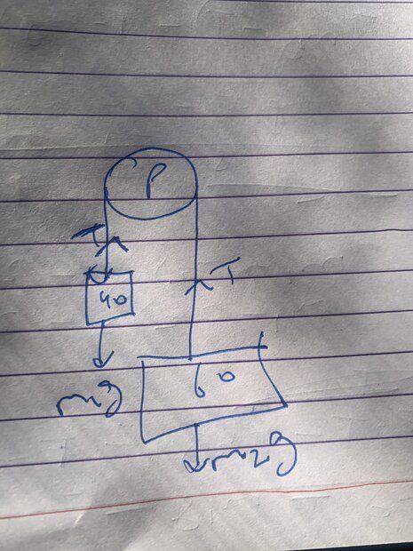

  • #31
Steve4Physics said:
This means acceleration of the centre of mass of the combined masses will be downwards
Steve4Physics said:
It looks like you are specifically thinking about the acceleration of m2 and the string on the right side of the pulley
Both are same.
  • #32
rudransh verma said:
Obviously the acceleration will be downwards.
The acceleration of what, exactly?
  • #33
Of combined mass:headbang:
  • #34
The combined mass does not have a position or a velocity or an acceleration. Perhaps you mean the center of mass.
With this acceleration defined, one could indeed write down an equation for the individual accelerations of the individual masses ##a_1## and ##a_2## in terms of this ##a_\text{cm}##
  • #35
Why do you say that?
  • #36
Because it is true. The combined mass is not a compact body. It does not have a well-defined position. Which leaves the first and second derivatives of position likewise undefined.
  • #37
Ok. Then yes center of mass
  • #38
OK. Suppose that you have this ##a_\text{cm}## defined.
Can you write an equation for ##a_1## and ##a_2## in terms of ##a_\text{cm}##? And do you really want to go down this road to solve the problem?
  • #39
No! I don’t. But I think if I get the resultant force and combined mass then I can find the acceleration a of mass 1 , mass2, center of mass, etc .All will be same.
  • #40
I believe that the problem can be attacked in this manner. It is not a wise approach. But it is possible.
You will have to account for the force from the pulley. This is currently an unknown that does not appear in your equations. More unknowns. More equations. More stuff to solve. Not ideal.
We can write one equation down. ##\sum F = ma## $$-gm_1 + -gm_2 + F_\text{pr} = (m_1+m_2)a_\text{cm}$$Here ##F_\text{pr}## denotes the net force of the pulley on the rope.
  • #41
For information, I get:
##a_1 = +2m/s^2##
##a_2 = -2m/s^2##
##a_{cm} = -0.4m/s^2##
Three different values!
(If you wamt to find ##a_{cm}## for yourself, here’s a hint: the pulley is not accelerating so the upwards force on it equals 2T where T is the tension. The total downwards force on the system is ##m_1g + m_2g##.)

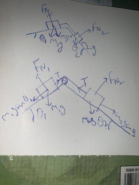

  • #43
Steve4Physics said:
Method 3 (for acceleration).
Realise the magnitude of acceleration is the same as that of a total mass of M=m1+m2 accelerated by a force, F, which is the difference in weights (F=(m2–m1)g). Then use F=Ma. That gives the acceleration very simply; then you can easily find tension if required.
To be clear since the tension is same and opposite(even though it doesn't look in the diagram) the net force is simply the difference of the weights and we can say the system will move in the direction of heavier weight.
But this is not always true as in the case of incline with two masses one hanging from the pulley and other kept on the incline.
https://www.physicsforums.com/threads/two-blocks-a-pulley-and-an-inclined-plane.1011992/
  • #44
'Method 3' (in Post #13) is for solving Atwood Machine problems with both masses hanging vertically.
However if one or both masses are on an incline, Method 3 can easily be modified.
If ##m_1## and ##m_2## are on inclines of ##θ_1## and ##θ_2## (to the horizontal) respectively, we must consider the downhill component of each weight: ##m_1gsinθ_1## and ##m_2gsinθ_2##.
For example if ##m_1gsinθ_1 > m_2gsinθ_2## then ##m_1## accelerates downhill.
(To get the direction, you don’t actually need to include 'g' as it cancels; you can just compare ##m_1sin θ_1## and ##m_2sinθ_2##.)
The net accelerating force is ##(m_1sin θ_1 – m_2sinθ_2)g##.
Note:
If ##θ_1=θ_2=90º## we have the Atwood machine.
If ##θ_1=0## and ##θ_2=90º## we have ##m_1## on a horizontal surface and ##m_2## hanging vertically.
  • #45
I am not talking about this method. I am asking you to verify what I said.
  • #46
So you are asking for a verification of of the correctness of:
Yes, correct for a single pulley from which two weights are suspended vertically.
Strictly speaking, the system will "accelerate" in this direction and will "move" in that direction if it begins at rest.
And you want a verification of:
Yes. If one or both of the masses slides down a slope (with or without friction), things are more complicated. The heavier weight may not always accelerate down-slope. Or, if friction is high enough, may not move at all.
  • #47
Thanks 😊
Steve4Physics said:
The net accelerating force is (m1sinθ1–m2sinθ2)g.
yes! I got you
