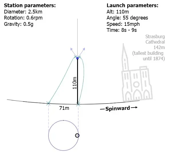

I had thought about that. Different places in the colony would produce different results. Interesting locations might include:A.T. said:I meant an approximate helix winding around the rotation axis. The airspeed would be decreasing as the water is slowed by drag.

Can you be a bit more specific about the fountain environment?DaveC426913 said:TL;DR: If you were gong to construct a fountain inside a hollow-rotating asteroid colony, what could you do to highlight the weird effects?
I suppose that the asteroid can be modeled as a spherical shell in which the gravitational field is zero. You put a fountain inside as shown in post #30.
Let ##\vec L## be a vector of magnitude 110 m pointing from the base of the fountain to its nozzle. I have two questions:
1. Does ##\vec L## point towards the center of the sphere?
2. What is the angle between ##\vec L## and the angular velocity ##\vec{\omega}## of the asteroid?
DaveC426913
2025 Award
- 24,696
- 9,099
kuruman said:Can you be a bit more specific about the fountain environment?
Gravity due to mass is zero.
Artificial gravity due to rotation is 0.5g.
(see specs, top-left in diagram)
It's a rigid tower, 110m tall. The water shoots out from the top: 15mph at an angle of 55 degrees. (grey vectors)kuruman said:Let ##\vec L## be a vector of magnitude 110 m pointing from the base of the fountain to its nozzle.
(see specs, top-right in diagram)
I think this renders your questions moot, no?

You can play with the numbers as you see fit in this calculator. It produced the blue curves seen in the diagram (everything else was added by me).
It will show you relative vectors and absolute vectors.
- 16,099
- 9,306
The calculator assumes that you have a rotating floor such that the angular velocity of rotation is perpendicular to the floor. It provides a path given an initial velocity and position for a mass moving without friction across the floor. It is not the hollow asteroid that you mentioned in post #1.
So when I look in the post #43 figure, the water emerging from the nozzle is moving in the plane of the rotating platform, correct? I am asking because I want to do some trajectory calculations and be sure that I understand the problem correctly.
Is it the case then that we have a rotating platform on which we shoot a puck from some initial position with some initial velocity. If the puck zaps dots on the platform as it moves across it to edge of the platform, what would the path look like when we connect the dots? Is this a fair assessment of the problem?

"The effect is not unlike the acceleration due to real gravity."kuruman said:The calculator assumes that you have a rotating floor such that the angular velocity of rotation is perpendicular to the floor. It provides a path given an initial velocity and position for a mass moving without friction across the floor. It is not the hollow asteroid that you mentioned in post #1.
OK, it's not a 100% match.
The water is emitted in at 55 degrees from horizontal at 15mph.kuruman said:So when I look in the post #43 figure, the water emerging from the nozzle is moving in the plane of the rotating platform, correct?
This is all specified in the diagram.
I am not prepared to say so, no. Not off-hand. But I'm interested to see your simulations.kuruman said:Is it the case then that we have a rotating platform on which we shoot a puck from some initial position with some initial velocity. If the puck zaps dots on the platform as it moves across it to edge of the platform, what would the path look like when we connect the dots? Is this a fair assessment of the problem?
One thing that the sim doesn't factor in is air resistance, which is not insignificant.
