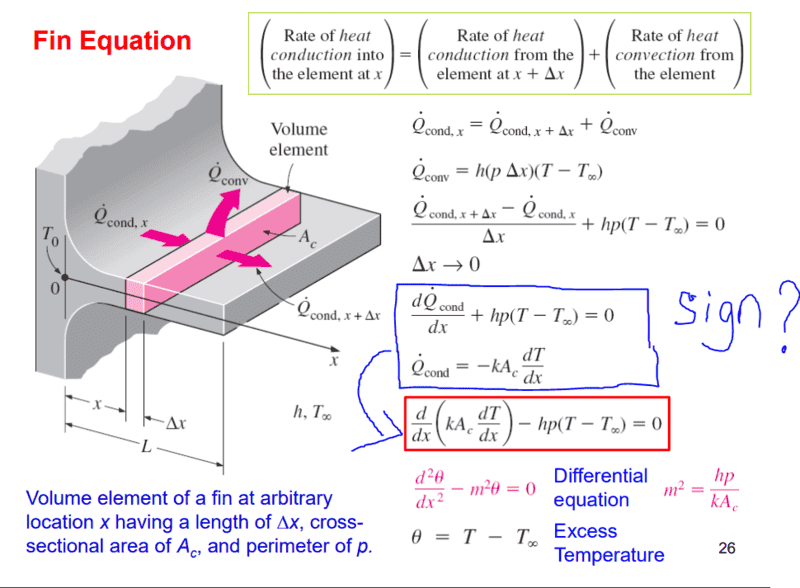

What happened to the negative sign?
- Thread starter EastWindBreaks
- Start date
The discussion centers on the confusion regarding the application of the negative sign in the equation d/dx(-kAc*dT/dx)+hp(T-T)=0. Participants clarify that the negative sign is crucial for maintaining the equivalence of the terms in the equation. The focus is on ensuring that the signs on the hp() terms are correctly compared to avoid misinterpretation. This highlights the importance of careful algebraic manipulation in thermodynamic equations.
