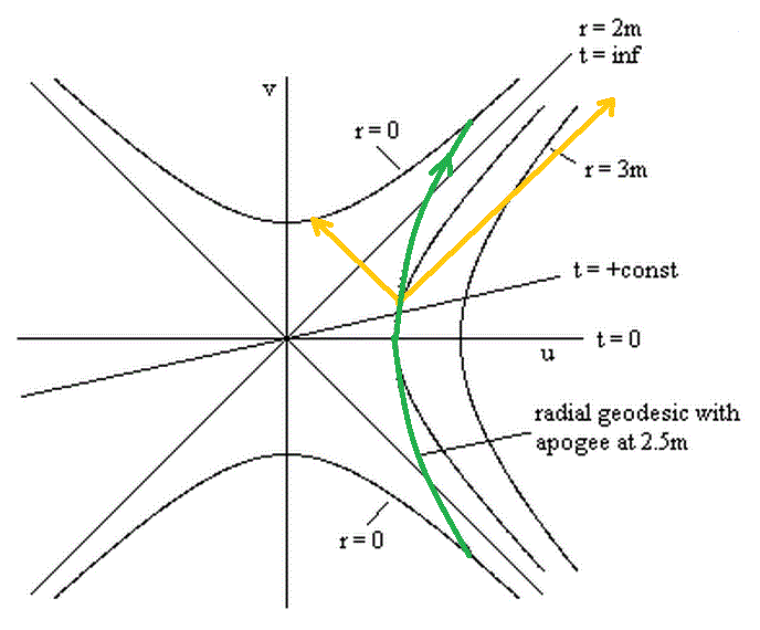

When an observer approaches an event horizon to one plank length away one of two things must happen:
1). Any observers previously falling towards the black hole would be right along side you.
2). There is distance between you and the light from previous in-falling observers when you're right on the horizon. That would mean you would have to be seeing light from inside the horizon, although it's light that hasn't reached the horizon yet, which is paradoxical because you can't tell if they crossed. How can you be hovering the same distance away from the horizon as a previous observer and have space between you?

But if you're right next to the horizon and you never see them cross the horizon then how can there be space between you?
Maybe it would be clearer if you thought of spaceTIME instead of space?...
Peter #33:
If you are orbiting the black hole at some radial coordinate r outside the horizon, you will see the effective mass of the black hole increase as soon as the infalling object falls inside your radius. (Strictly speaking, this is what you will see if the infalling object falls right by you on its way in; i.e., if its angular coordinates theta, phi are exactly the same as yours. If it falls at some other theta, phi, it may take time for the effect to propagate to you before you actually see an increase in mass.)
PAllen #82
"So if you are close enough to the horizon you can observe objects crossing it?"
This is getting repetitive. You are seeing an old image from before they crossed. It is from when they were still (in my prior example) 10 feet from you but right near the horizon. This light takes a while (up to forever) to reach you.
If previous falling observers are "right alongside you" then they are exactly one Planck length away from the EH and therefore did not fall earlier but simultaneously. The sentence is a self contradiction. (Perhaps the letters got mixed up when you stirred the soup? ...hehe :P ) Previously falling observers will be less than a plank distance away from the EH. Of course you might be assuming that there cannot be a distance of less than one Plank length but that is unproven and unlikely and you seem to assuming that we are living in a spatially digital universe. Also bear in mind that due to gravitational length contraction (for want of a better term) what we call one Planck length from a coordinate point of view might well be measured as a distance of several Kilometers from the point of view of local observers. Where do we define the Planck length? Locally or in coordinate terms?
Also bear in mind you cannot see light emitted from inside the EH or even exactly at the EH. even if you one Planck length outside the EH.
This is looking soupy too. You said you are "right on the horizon" which to most people would mean you are exactly zero Plank lengths from the horizon but then you say you are hovering the same distance away from the horizon. If you are hovering you cannot be exactly zero Planck lengths away from the horizon so again you are contradicting yourself. Are you on the horizon on just outside it? You seem to be using one Planck length to mean a finite non zero quantity sometimes and at other times pretending that one Plank length is as good as zero, when in reality they are worlds apart. It is similar to saying that traveling at 99.9999999999% of the speed of light is as good as traveling at the the speed of light when they are worlds apart.

First, please note that Sam Gralla's comments are correct: if we are talking about classical GR, there is no "minimum distance" that something can be above the horizon, so the Planck length is irrelevant; above the horizon is above the horizon. Everything I say in what follows will assume that the questions above have been modified appropriately.
There's a model of Schwarzschild black holes that might be helpful in visualizing how all this works: the "river model" of black holes. See this paper:
http://arxiv.org/abs/gr-qc/0411060
Basically, the idea is that space is flowing inward into the black hole's singularity; at any given radius r, the rate at which space flows inward is the "escape velocity" at that radius. So space is like a "river" that continually flows inward, carrying things along with it.
If you are free-falling into the hole, you are basically at rest in the river, so you are moving inward at the same rate the river is. So suppose you are free-falling inward, and you have a blinker below you that sends repeated flashes of light back up to you. The blinker is attached to you so it stays at the same physical distance from you; we assume that the hole is large enough that tidal gravity is negligible until you are almost at the singularity, so the blinker can remain attached to you safely. The light from the blinker is moving "against the stream", so to speak, at the speed of light--that is, it moves outward at the speed of light *relative to the river*.
But relative to the "river bed", that is, relative to observers "hovering" at rest at a constant radius r, the light moves outward *more slowly* as you get closer to the hole (because the river flows inward faster). At the horizon, the river is flowing inward at the speed of light, so outgoing light is just able to cancel out the flow and remain at the same radius, the horizon radius, forever. Inside the horizon, the river is flowing inward faster than light (this is OK because the "river bed" doesn't actually exist physically, it's just an aid to visualization), so even outgoing light rays are dragged inward (just more slowly than anything else in the river).
Now consider flashes of light emitted by the blinker at various points as you fall. To you, they all look the same: they rise toward you at the speed of light, and take the same time (relative to your clock) to reach you. However:
(1) A flash emitted far away from the hole will be moving outward, relative to the river bed, at almost the speed of light (since the river is flowing inward very slowly). So an observer "hovering" at rest relative to the river bed will see things pretty much the same way you do.
(2) A flash emitted when you are getting fairly close to the hole will be moving outward, relative to the river bed, somewhat slower than the speed of light (since the river is now flowing inward at an appreciable fraction of the speed of light). So the observer will see the light rise more slowly than you do; to him, it will look as if you are falling to meet the light, to some extent, rather than the light rising to you.
(3) A flash emitted when the blinker is just above the horizon will be moving outward *very* slowly; and you yourself will be falling, relative to the river bed, at almost the speed of light. So to an observer "hovering" at rest there, the light hardly seems to move at all; instead, you fall to meet it at a point just slightly above the point where it was emitted, relative to the river bed. In fact, if the flash is emitted close enough to the horizon, the blinker itself might actually be *below* the horizon by the time you have fallen to meet the flash of light.
(4) A flash emitted when the blinker is exactly *at* the horizon stays at the horizon; as noted above, the outward speed of the light at the horizon just cancels the inward speed of the river, so the light stays at the same place relative to the river bed. So you will see the flash exactly when you, yourself, cross the horizon. By that time, though, the blinker will have fallen below the horizon; the blinker itself does not "wait" at the horizon for you, only the flash it emitted at the horizon does. So the blinker will not be "next to you" when you cross the horizon; it will be further inward, just as it is throughout your fall.
(5) A flash emitted when the blinker is below the horizon moves *inward*, relative to the river bed, even though it is emitted outward; as noted above, even outgoing light is dragged inward in the region below the horizon. But the outgoing light is dragged inward more slowly than you are, since you are moving with the river; so you will still catch up to each light flash emitted by the blinker. When you do catch up to each flash, the blinker will have fallen further than it was when it emitted the flash, since it is also moving inward faster than the outgoing light is.
