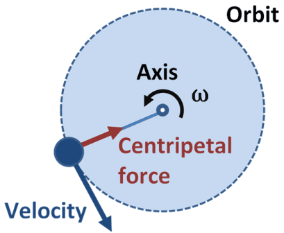

centripetal means "center seeking". It's not a fundamental force itself, it's more of a scenario that involves a fundamental force.
Orbit is a common example. An object must have the right velocity to orbit Earth. The planet's gravity is pulling it in. Since the velocity is just right, it continues in orbit, always being pulled toward the center of Earth, but never really getting closer.
Notice that the velocity is directed slightly opposite of the force pulling it in. With the right velocity, it's just enough so that it's always correcting itself due to the force, perpetually orbiting.
A more personable example is when you're taking a turn in your car. Your velocity is still going straight, but you're turning the car, so the car's driver side door pushes on you as it turns and makes you turn with it. Here, the door is exerting a centripetal force on you.

Velocity has both magnitude (speed) and direction. For circular motion, the centripetal acceleration is the rate of change of the velocity due to its changing direction.

Centripetal (same root as "petition", from the Latin for "seek" :wink:) acceleration is geometry, not physics.
Anything going along a curve has a centripetal acceleration equal to speed squared over radius of curvature. :smile:

mV^2/R = ma => a= V^2/R This is basically centripetal acceleration, in case if you are really asking this.
From what I understand centripetal acceleration is the type of acceleration that causes circular motion. For example of you swing a yo yo around your head the direction is constantly changing and therefore so is the velocity, if the velocity is changing then the yoyo has an acceleration. Now as for the direction of this acceleration? well if the yo yo is being swung in a circle it is pointing inward down the line of the yo yo toward your hand. So the acceleration vector points along the radial line voila.
To show this more rigorously . Choose a point P on a path of circular motion and draw its velocity tangent to the path of motion. notice the angle theta swept out by the velocity vector as it changes by magnitude delta v is the same angle as is swept out but magnitude of v during a change in time dt and so you can write (d v)/v =v(d t)/r and it follows that dv/dt=v^2/r this is the expression for centripetal acceleration. Like someone already stated, its a consequence of the geometry of the situation. Angular acceleration, however is a direct measure of how fast the rate of rotation wrt time.

Centripetal acceleration is not the rate of change of direction--it's the rate of change of velocity due to changing direction. For an object in uniform circular motion, the angular acceleration is zero but the centripetal acceleration is certainly not zero.
