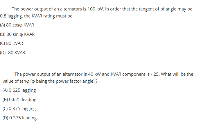

My book had these two solved examples that gave contradictory replies.
The power output of an alternator is 100 kW. Now if the tangent of pf angle is 0.8 lagging, the KVAR rating must be -80KVAR.

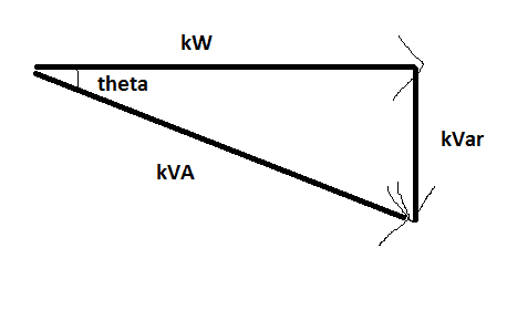

I drew phasor and got this.
I took it that since tangent is negative. Now tangent is opposite divide by adjacent, so negative tangent mean opposite component angle - adjacent component angle is negative, it means that opposite lags adjacent component.But then the next section had this example:
The power output of an alternator is 40 kW and KVAR component is - 25. if theta is power factor angle then the value of tangent of theta, is 0.625 leading.
Here if we see then KW is positive in phasor and KVAR is negative in phasor. So tangent of theta is tangent of (-25/50) is -0.625. But it should be lagging since KVAR is lagging KW. So is book wrong in saying tangent of power factor angle is leading 0.625.
Is first phasor right or second phasor? Is tangent of power angle leading different than power factor leading?

Above is screenshot. It's solved example. The answer to first was D, and second was B. I didn't really get it. Does tangent power factor angle lagging mean power factor is lagging right?
I still think there's a mistake in your textbook.
An author must be meticulous about defining his terms and sign conventions.
My Mother-in-Law was an editor for Wiley. She said it is common for authors to assign to graduate students the writing of exercise examples and homework problems. Editors too hire grad students to check the examples and homework problems for correctness.
So an inconsistency might have slipped past the editors.

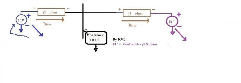

Best bet is to go back to basics and draw a phasor diagram of minimal system:
just two machines connected to a bus both at zero real power. Raise excitation on one , adjust excitation of other to restore system voltage.

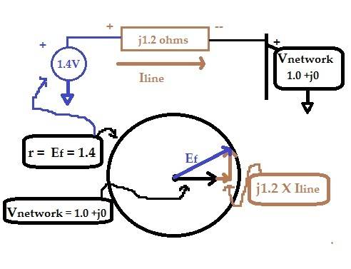

I made this drawing last Spring for another thread. It represents one machine delivering power to an infinite bus .
I started to redraw it for above thought experiment, got flustered . Will probably try again later
Numbers are arbitrary, for simplicity i'd change the 1.2 ohms to 1 ohm and let it represent per-unit Zsynchronous.
Ef phasor needs to be redrawn in phase with Vnetwork.
Reactive current phasor will be perpendicular to Vnetwork.,
Then add a second machine on the right side in different color maybe purple call it Ef prime, Ef ', .
Phasors for ( Ireactive X j1) will subtract from horizontal Ef and add to horizontal Ef '
because by KVL one is +j2 Iline and one is -j2 Iline.

Here's what it looked like after i erased my mistakes...
old jim
wow you can see I'm no painter.

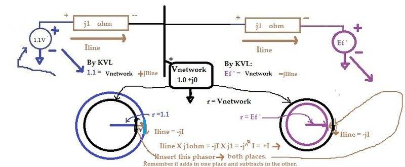

As we know, reactive current directly aids or opposes field current
and that's reflected in the phasor diagramsolve both machines for Vnetwork, which is machine terminal voltage
Vnetwork = 1.1 - I , lagging reactive current opposes internal voltage
Vnetwork = Ef ' + I, lagging reactive current aids the internal voltage
Now you should repeat the thought experiment to see what happens if neither machine has a voltage regulator,
ie when you change excitation of one machine, other's excitation remains constant and network voltage is allowed to come to a new value. .
i don't feel I've made a good explanation here. Needs to be smoothed.
But i hope it helps. Point is , define your conventions and stick with them. Become fluent enough to work with somebody else's conventions, translating them into yours if need be.
Seems self contradicting, doesn't it ?
EE is that way - one must be aware and rigorous with his conventions and assumptions.
Observe i assigned directions and polarities in my Paint sketch, despite its primitive appearance.
If one wants to make a general memory aid,
i'd add direction to those statements
lagging reactive current EXITING a machine opposes its excitation
lagging reactive current ENTERING a machine aids its excitation
When one studies armature reaction it becomes intuitive.

Black Circles: radius of black circles is amplitude of terminal voltage. They're the same because i copied and pasted.
Angle of terminal voltage i chose as zero, my reference. Black circles would have horizontal line for their phasor, but it gets overlaid with blue and purple and brown a couple steps further along in the drawing.
Blue and purple circles have radii equal to internal voltage of the alternators.
Blue and purple phasors also have angle zero because ( remember my sneaky trick?) real power is zero hence so is power angle, meaning they are in phase with terminal volts so lay atop the horizontal black radii covering them up.
The brown vertical phasors represent armature current
which get rotated 90 degrees as they flow through machine's Zsynchronous and become horizontal phasors too
one of them adds to internal voltage the other subtracts from it (by KVL)
I could have made a separate sketch for each step but didn't
you can draw it easily, just go one step at a time.
old jim
