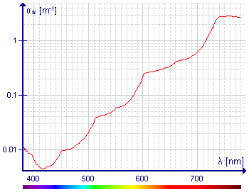

I saw this on Wikipedia
http://en.wikipedia.org/wiki/Electromagnetic_absorption_by_water
Isnt it supposed to less than 1 ?
maybe it has something to do with the unit ..why is it in m^-1?
"m^-1" reads "per meter". What dimensions were you expecting?
It's a good point: how can you possibly absorb more than 100% of the incident radiation?
But that ##\alpha_w## which is on the vertical axis is the "attenuation coefficient", is this the same as "absorption coefficient"? There is a link to the definition under the top graph in your link, did you check it out?

well obviously but I was expecting it to have no units .. there are three types of coefficients you take into consideration when a beam of light hits an object: the reflection co ,the transmission co, and the absorption coefficient and they're all equal to 1
α+β+τ=1
so the absorption co α has to be less than 1

and this is where i got the chart, I clicked on that link but I could not understand s***
That page gives you an equation: $$I(z)=I_0e^{-\alpha z}$$ ... where z is the distance through the material. I0 is the incoming flux, and I(z) is the flux after distance z.
This means that $$\alpha_z = -\frac{1}{z}\ln\left|\frac{I(z)}{I_0}\right|$$ ... so if a particular distance through the material removes roughly 35% or less of the incoming light, then the coefficient will be bigger than 1. A dimensional analysis will tell you what units ##\alpha## should have.
