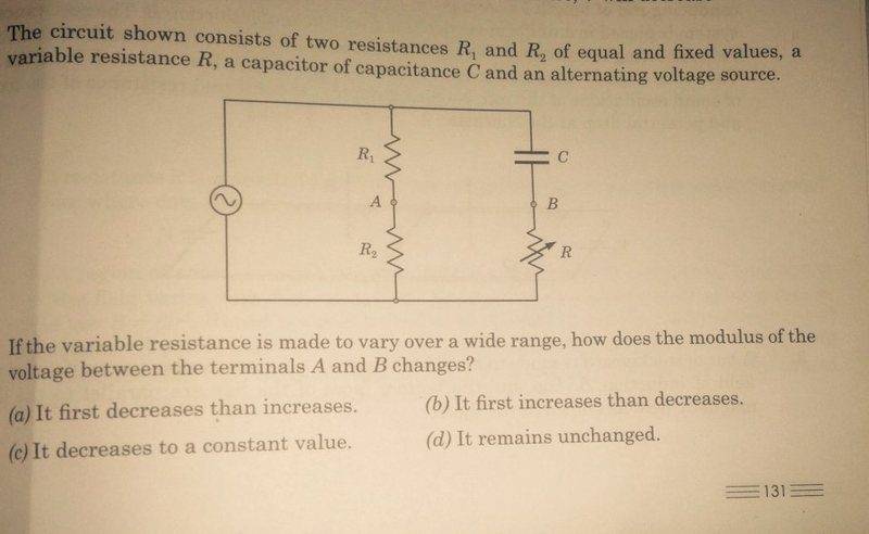

What is the approach to solving this AC circuit voltage problem using phasors?
aryan pandey
the problem is given in the attachment
basic knowledge of ac circuits and phasor diagrams
for point A , i calculated the potential easily. and for point B , i calculated the potential using phasor relationship .. now after doing VA - VB, i got the relation that its modulus will first decrease and then eventually increase
but in the answer given is that modulus of VA - VB will remain unchanged.
You'll have to show the details of how you got your relation. Can't fix what we can't see :wink:
truely speaking , i am confused how to proceed this question and hence not able to provide my approach .
through this question i want to grasp the concept of the question.

Well, could you post the phasor diagram that you've drawn?
What can you say about the locus of VB from the fact that R1 and R2 are equal?

You should think about the extreme cases. What hapen when R=0 and when R tends to infinity maybe that helps as a start. Anyway you have to get an equation for Vab in function of the variable recistance.

Start by writing expressions for the potentials at points A and B. You referred to phasors, and that's a great idea. You can work graphically or algebraically (complex value phasor representation). The complex value method employs complex impedances.
Hint: Since the AC frequency is not changing the reactance of the capacitor will not change: It will be a constant. So just assign an arbitrary name to the capacitor impedance, say -jZ. (You do recall that in terms of phasors the impedance of a capacitor has a negative imaginary value, right?)
