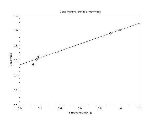

By inspection of the following planetary data (Earth-normalized units), we find that average density (p) scales linearly with surface gravity (g):
p = p0 + k x g (Nilssen's Law)​
where
p0 = 0.536 [ 2.96 g/cm3 ]
k = 0.464 [ 1 - p0 ]
Since surface gravity scales as the product of average density times radius, we may substitute and solve explicitly for average density, and mass (M), as functions of radius (R):
p = p0 / (1 - k x R)
g = p0 x R / (1 - k x R)
M = p0 x R3 / (1 - k x R)
This relation substantially agrees with previous models*. As w/ Nilssen's Law of Stars**, surface gravity acts as a "compressive force" which increases density. Since, however, rocky worlds are solids, p0 represents the "uncompressed density" of rocks at zero-gravity. Its value (2.96 g/cm3) substantially agrees with the estimated densities of asteroids (~2.9 g/cm3***).

I don't think surface gravity is a sensible independent variable. When coalescing, the protoplanets didn't say to themselves, "Hey, let's form a configuration with such-and-such surface gravity!" Surface gravity depends on radius and composition, not the other way around.
For a sphere of uniform density, surface gravity increases linearly with radius. So it's not surprising that you get something like this. However, even you must admit that you are being selective with your data: tossing Mercury out and the Moon in, because one agrees and the other doesn't . There are 9 bodies in the solar system as large as or as heavy as the moon. There are 126 ways to pick 4 of them, so it's not that hard to find a pattern when one has the ability to cherry pick the data.

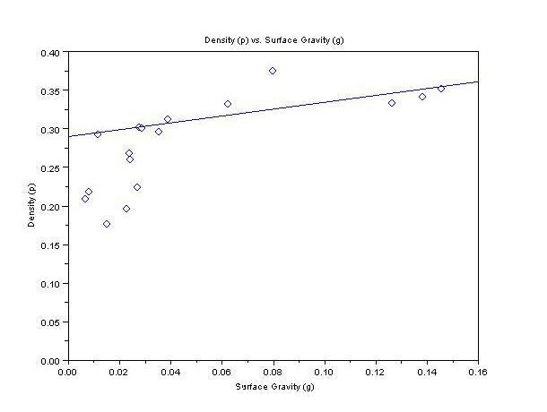

I analyzed all the spheroidal Icy Moons, of all the Gas Giants, plus Pluto & Charon. I found that Icy Worlds all (basically) obey a similar simple scaling law (Earth units):
p = p0,ice + kice x g
where:
p0,ice = 0.29 (~1.6 g/cm^3)
kice = 0.44​
However, seven (7) of the smallest Icy Worlds are under-dense, perhaps b/c they are "rubble piles", have undergone extensive off-gassing [sp?], etc.

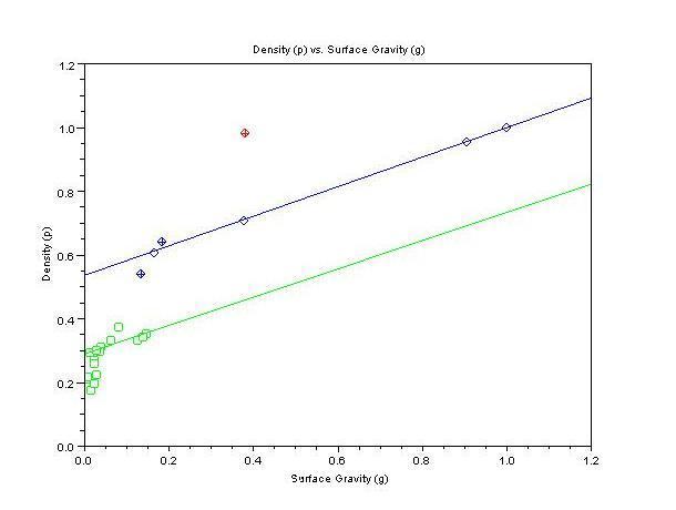

Attached are figures visualizing the data, and these fit-lines. Steam Zone worlds (ie., Mercury) are drawn in red; Water Zone worlds are in blue (also including Io & Europa); Ice Zone worlds are in green.
Please excuse the lack of graphical annotations. If anyone knows how to annotate graphs in SciLab, please speak up.
ADDENDUM: Note that kice (0.44) is almost the same as krock (0.46). Only the "uncompressed density" increases. So, both Rocky Worlds & Icy Worlds have essentially the same "bulk compressibility". This suggests that Steam Zone worlds (eg., Mercury) might obey something like:

The whole process that lead to this "law" is deeply flawed. Earth and Venus have nearly the same mass and radius, so wherever one data point is, the other one is right there as well. Add Mars, and now you have two data points. Two points determine a line. So the only independent test is whether anything else ends up on this line.
Out of all the other objects, only one, the moon, ends up on this line. You dismiss the others for a variety of ad hoc reasons. For example, you reject Mercury (which doesn't end up on the line) because it's composition is different than the earth's, but accept the moon (which does end up on the line) even though it's composition is also different. This isn't how science operates.
Please look at the graph again. Venus, the Earth, the Moon, and Mars all lie precisely upon the line, to w/in one pixel on your screen. The only 2 of the 6 data points slightly off the line, are Io & Europa, which "should" be Ice Worlds (having formed out beyond the Sun's Snow Line), but coalesced near the hot proto-Jupiter, which boiled out most of their volatiles.
Do you understand, that Mercury formed in an entirely different Formation Zone from the four above worlds??
