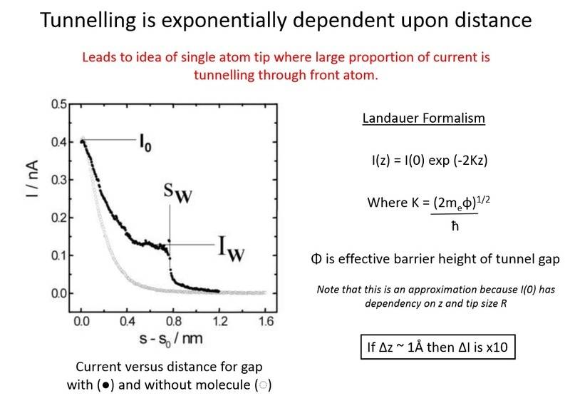

This is only a 1 mark question so I'm probably missing something really simple but I just can't figure it. Below is the slide we have been given:
Does anyone have any ideas?
It should be ~1V so the square potential is not deformed and the probability increase due to curved edges of the potential.
