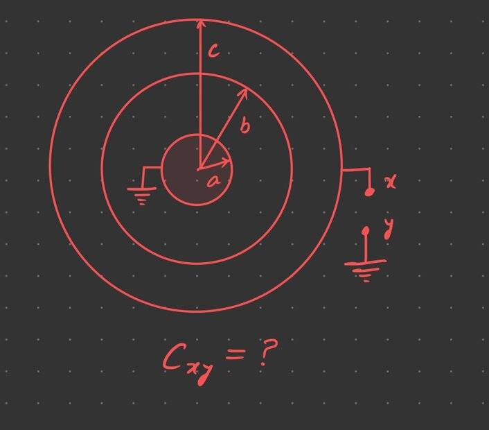

Hand-drawn schematic of three concentric circular shells with radii labelled a, b and c; the inner shell is grounded on the left, the outer shell has terminal x on the right, and terminal y sits below it at ground. Caption: Cxy = ?
A friend of mine sent me this problem about finding the capacitance.
We have three concentric shells of radius a, b, c. And we've to find the capacitance between x and y.
I need help.
Thank you
Among many ways, you could treat it as two capacitors (a,b ---b,c) in series. What is the capacitance of two concentric shells?
I would love to get a hint to do it any other way. Something that is more basic, like by using just the starting definition of C=Q/ V.
Thank you for your reply :)
