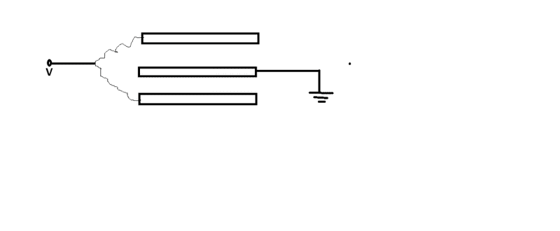

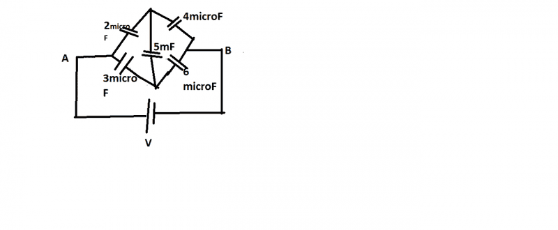

find the charge on each plate given area is a and separation between two consecutive plate is d
##Q##=##C####V##
I don't know how to proceed from here.
You need another relevant equation. What is the capacitance of a parallel plate capacitor with plate area ##a## and plate separation ##d##?

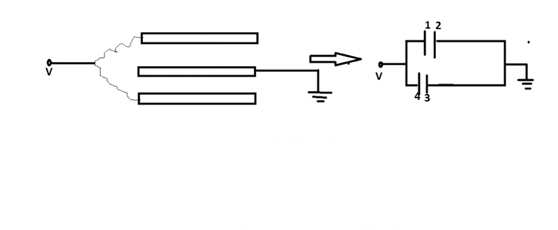

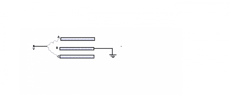

Each capacitor plate in your circuit diagram will have the same magnitude of charge on it. You'll have to sort out the signs of the charges. Then determine how to locate those charges on the plates of the original figure -- remember, one physical plate is shared between two capacitors.
But hint says plate B would have different charge.

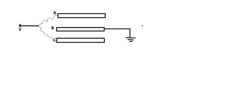

Yes. I presume "plate B" is the middle plate of the physical setup? You didn't label your diagram.
Note that I said: "Each capacitor plate in your circuit diagram will have the same magnitude of charge on it". There is a distinction between the circuit diagram and the physical arrangement in that the circuit diagram shows two plates in two separate capacitors whereas the physical setup uses a shared plate. Re-read the entire contents of my post #8.

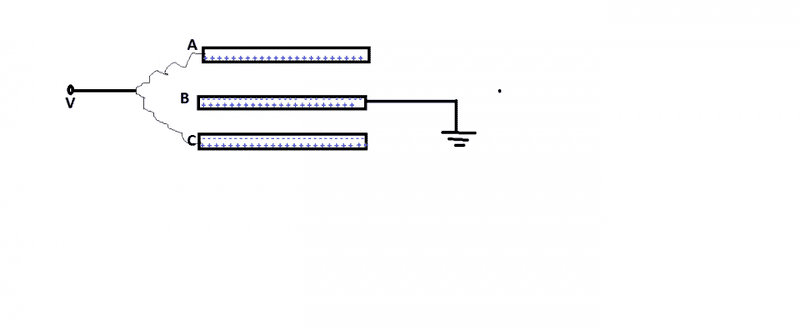

Should not plate B cntain zero charge as it is earthed?
No, "earth" is a vast pool of available charges, both positive and negative and overall neutral. It can supply whatever charge is required to respond to electrostatic forces. Or, if you like, it can source or sink any amount of electrons, if you want to go with an atomic model for the plates and conductors.
Your charge placement is not correct. Note that plates A and C are symmetrical and connected to the same potential (V). They should end up with similar charges distributed in the same way. Charges are made available to those plates via their connection to V. So far I think we've been assuming that V is a positive potential with respect to ground (earth), which is fine, but you should state that assumption in your solution.
I don't quite get the relationship between being symmetrical and connected to the same potential and having same charge distribution.
I distributed charge by only considering charge induction.

Plates 2 and 3 along with the wire joining them, form plate B in your original question.
gracy said:
Q=Vaε0d\frac{aε0}{d}
That is for one capacitor(1-2 or 3-4). The capacitors are in parallel. So you can find the total charge now.
If you rotate the drawing on the page, do you expect the charges on the plates to change? Is there any distinction (electrically) between the two outer plates?
You'll have to explain how you ended up with different distributions on the two outer plates.

A and C are connected to same potential V and you have shown net +ve charge on A and other plates neutral. Why A? Why not C?

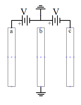

Its 'grounded' i.e it is at 0 potential. It doesn't have to be an actual earthing. It can be battery's -ve terminal.

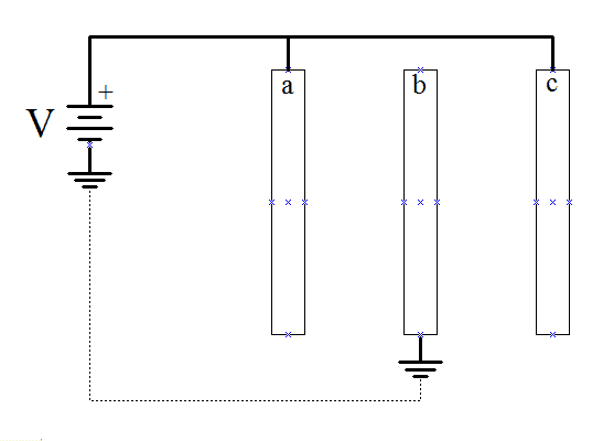

But in the following image(my op)there is only one lead connected and it is written "V" so in such cases it is assumed that other point is earth."V "is potential difference between the one terminal shown and the earth.Right?

No. Charges will be "pushed onto" the outer plates by the voltage supply, and "pushed off" the middle plate via the ground connection. The plates will not remain neutral since charge can enter or leave via their external connections. In other words, there's no reason to balance the charges on the faces of any given plate so that they will sum to zero.
And again, the charge distributions on the outer plates should be symmetric with respect to the middle plate.

You yourself correctly interpreted the circuit as two capacitors in parallel connected across some voltage V. So the plates MUST have a net charge.
Right. Here's an alternative depiction of your circuit:

The symbol used is normally called 'ground' i.e. a reference point in the circuit. Normally, it is the negative terminal of the battery (exceptions do exist), however, you can choose any point in the circuit as reference. All the voltages are measured w.r.t. that point. Earthing is done from protection point of view. Anyways, this is not the point of the discussion, so I won't say much.
I still don't understand why plates can not be neutral.
