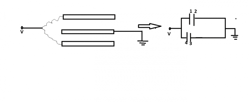

  • #61
How can we know this time Earth will give charges and at the other instance it won't?
  • #62
gracy said:
Should not q transfer direction be other way around in #54?
How so? The batteries are driving charge in the direction that a current would flow.

  • #82
cnh1995 said:
Sorry, I meant +ve charged part of the circuit like +ve terminal of the battery.
plate with net positive charge is at higher potential and plate with net negative charge is at lower potential,right?

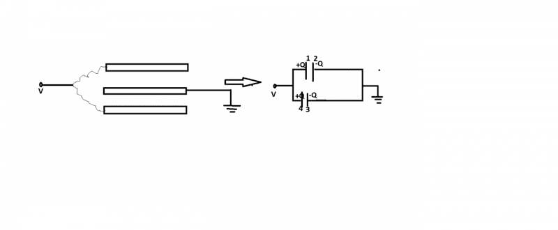

Why there is no potential difference between earthed plate and other plate(s) in #39
There is. It's established by the two batteries. Plate a is at +V with respect to the middle plate, and plate c is at -V with respect to the middle plate.
  • #85
Then why no charge transfer occur from Earth as charge are transferred from Earth if there is potential difference between earthed plate and the other plate(s)?
  • #86
I believe that's because it is connected to +ve terminal of one battery and -ve terminal of the other battery.
  • #87
Formation of net -ve charge is avoided by the +ve terminal of one battery and formation of +ve charges is avoided by the -ve terminal of the other battery. However, if the two battery voltages were different, there would be net charge on the middle plate.
