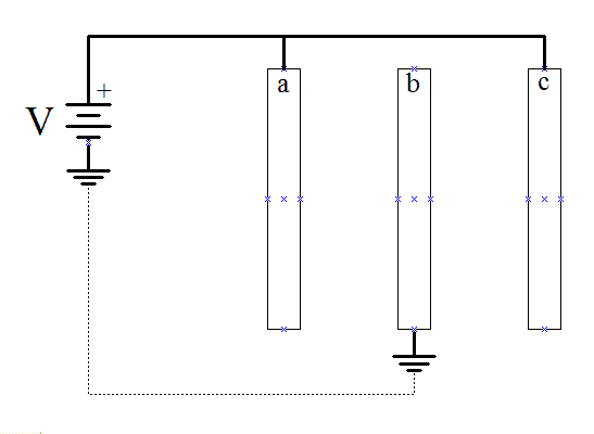

  • #32
gneill said:
. Charges will be "pushed onto" the outer plates by the voltage supply,
If there is a voltage connected to plates then it is impossible that plates would be neutral?
  • #33
gracy said:
I still don't understand why plates can not be neutral.
In general plates can be neutral, but they don't have to be if there are external connections over which charges can enter or leave them. Isolated plates are always neutral unless some charge has been deposited on them by some agency.

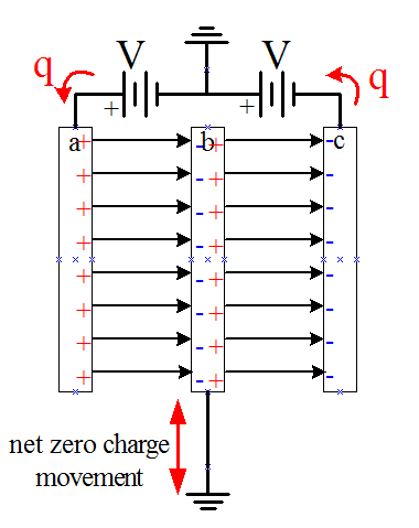

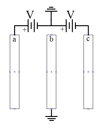

  • #39
gracy said:
If there is an external connections to plates then it is impossible that plates would be neutral?
That would depend upon whether or not the connects lead to something that will cause charge to flow (impose potential differences). Even so it is possible to arrange things so that the net excess charge will be zero! Here's an example:
The middle plate is externally connected (to ground), but is situated between two plates that have opposite potentials with respect to ground reference. The net result will be no excess charge on the middle plate, although it will have equal and opposite charges on its surfaces.
  • #40
But plate A and C have plus charges,right?
No, one will be plus, the other minus. Look at the polarities of the two batteries. One establishes plate a at +V potential with respect to ground, the other establishes plate c at -V potential with respect to ground.

  • #43
Yeah..right..
  • #44
cnh1995 said:
Seeing this diagram,can I say there won't be net charge on any plate because there isn't any 'closed electrical path "through" the dielectric'?
No, the electric fields between the plates established by the potential differences suffices to influence charge movement in the plates and wiring. Remove the central plate from the scenario and you have a typical capacitor with a potential difference of 2V across it.

Right.
  • #49
In my OP i.e picture in #28
plate B would have negative charges on both the side as it's adjacent plates are having positive charges,where will positive charges of plate B go as initially plate B was neutral ?I think all the positive charges of plate B would go to Earth and plate B would have net negative charge.
  • #50
Correct.
  • #51
Plate A and C would have net positive charge,right?
  • #52
Yes. The middle plate alone will have -ve charge whose magnitude will be twice the +ve charge on each plate.

  • #55
Because Earth can give as much plate needs.

  • #57
gneill said:
The situation calls for equal amounts of + and - charges on the middle plate, for a net sum of zero charge.
But Earth does not give them.Plate b already possesses that.
  • #58
That's one way to look at it.
If you look at this diagram, +ve terminal provides +Q charge to each plate, thus giving out total +2Q of charge. Hence, -ve terminal(ground) provides -2Q charge.
  • #59
Correct.
