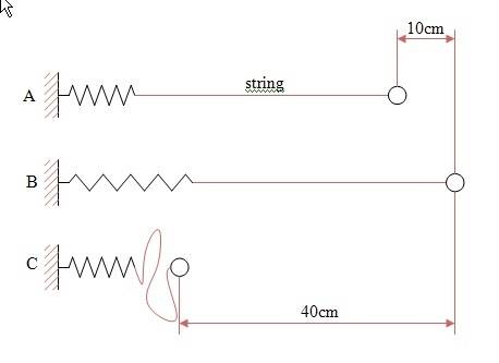

A spring with a constant k=10[N/m] is attached with a long rope to a weight of 0.05 kg. they both lie horizontally on the table. the string is stretched 10 cm and released and the weight travels 40 cm on the table until it halts. what is the coefficient of friction
Elastic energy of spring:[itex]E_P=\frac{1}{2}kx^2[/itex]
Conservation of energy:
[tex]\frac{1}{2}kx^2=mg\mu\cdot \triangle x[/tex]
[tex]\frac{1}{2}10\cdot 0.1^2=0.05 \cdot 10 \cdot \mu \cdot 0.4 \rightarrow \mu=0.25[/tex]
The answer should be μ=0.2

The system isn't like that. you don't start to pull the spring until the mass also moves, no. you pull the mass which pulls the string through the rope. i knew my simple drawing isn't good enough.
You pull the mass, which stretches the spring, a distance of 10cm and release.

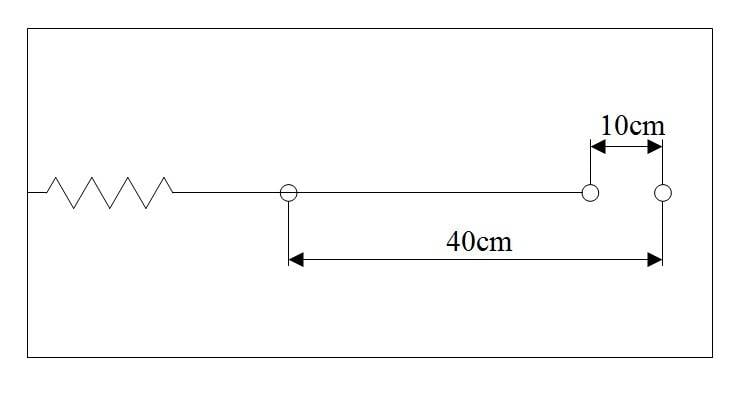

Installation
There can be no residual elongation of the spring because of the installation. the spring is pulled by a long cord. at the end of the cord is the mass. the mass is released and it travels until it stops, in front of the spring.
Right. I hadn't looked at this closely enough. It' doesn't seem complicated. The spring gives up all its energy. The mass travels 40cm.
So your calculations seem right. μk = 0.255
Maybe one of the data values isn't right? e.g., say the mass travels 51cm ...
OK, with this picture I don't see why your original answer isn't correct. Hope you can post what you found out later about it.
EDIT: I'll bet the spring traveled 40 cm from its original position. That makes Δx = 0.4 + 0.1 = 0.5 and then the answer is indeed μ = 0.2.
