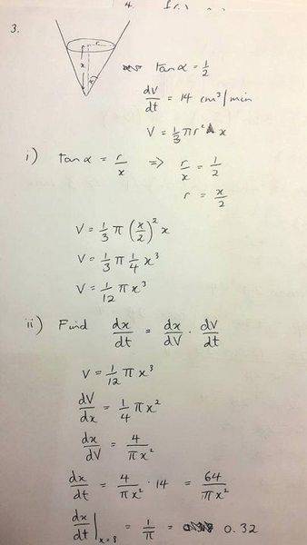

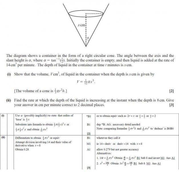

My problem is with part ii)
To me, my logic seems sound for the rate of change of depth but apparently it's wrong.
Does anyone see what I'm missing?
Thanks

In part ii) check your arithmetic. What is 4 ⋅ 14?
Oops! Thanks. Working too fast.
