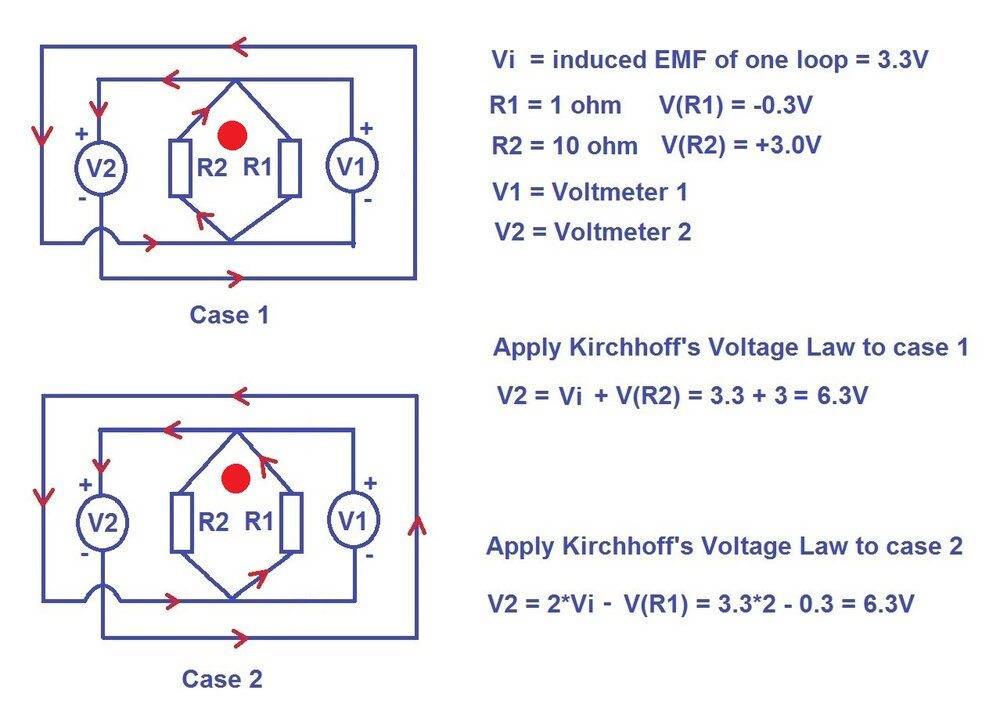

Interesting and seemingly tricky question about induced electromagnetic force
I think the answer to the first question is 3V and the answer to the second question is 6V
Does anyone have a different answer?

Because everyone has their own reasons and answers, I hope to give everyone time to think in their own way. When they see answers provided by others (not necessarily including the reasoning process), they may reconsider their reasoning. In addition, maybe many people (including myself) are not 100% sure that their answers are correct, so it is understandable that in this case, people may be patient and not rush to tell the details.
But you are also right. On the other hand, no one seems interested in providing answer so far. I might as well talk about my reasoning as follows,
Since the EMF of one loop is equal to 0.3+3=3.3V, the EMF of the two loops is twice, that is 6.6V, so the current of the two turns closed loop is equal to 6.6V/ (1 + 10) ohm = 0.6A, so the voltage across R1 becomes 0.6A*1 ohm = 0.6V , and the voltage across R2 becomes 0.6A * 10 ohms = 6V. :smile:
Close but wrong. On several counts. Sit out the spoiler -- it really is no punishment.
Thanks for the hint, I got it wrong. Instead of looking at the circuit diagram carefully, I built another circuit structure in my mind for reasoning. :oops:
Take a closer look at the original circuit diagram, the induced EMF of the newly added loop is just superimposed on the original V2.
