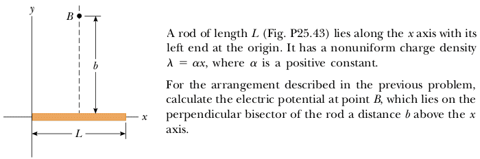

Here's the problem:
V = ke ∫ dq/r
V is the electric potential, ke Coulomb's constant, q the charge and d the distance.
λ = q / L , where λ is the charge density, q the charge and L the length of the rod.
I have one solution for the problem. What I want to know is why is my answer incorrect.
Since electric potential is a scalar and not a potential what I calculated was the electric potential produced by the left part of the rod, from 0 to L/2, and multiplied the resulted for two due to the symmetry of the problem (I thought that the electric potential produced by the rod from L/2 to L was the same as from 0 to L/2)
q = λ*L ⇔ dq = λ*dx ⇔ dq = α*x*dx
V = 2*ke*α ∫0L/2 x/sqrt(x²+b²) dx
I solved the integral and got:
V = 2*α*ke*[ sqrt( (L/2)² + b² ) - b ]
It is incorrect tho.
Any help will be appreciated!
Thanks in advance.

Read the problem text: λ=αx, the left end of the rod is at x=0. There is no symmetry.
ehild
