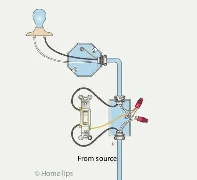

This diagram contains a switch leg:
Wiring diagram of a light bulb controlled by a wall toggle switch, showing a black hot wire and white neutral wire running to the switch box and back to the bulb socket.

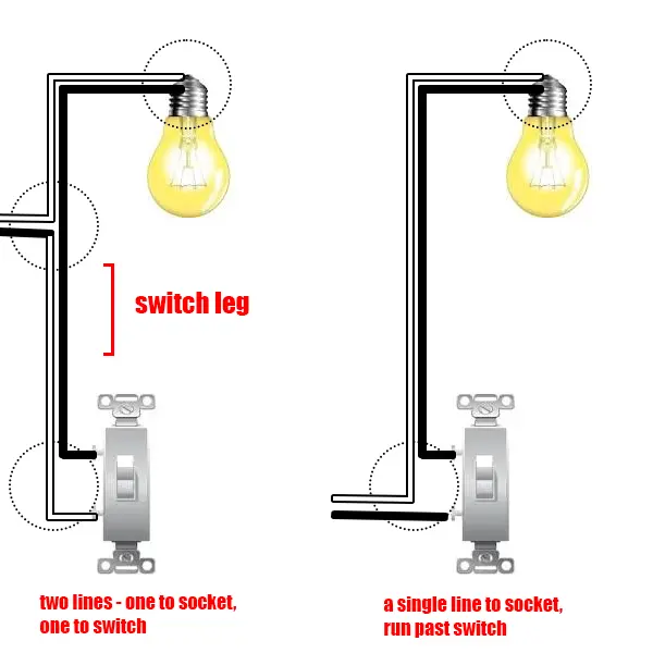

This one does not:
Wiring diagram of a light fixture controlled by a single-pole wall switch, showing a ceiling light, octagonal junction box, switch box, and a line labeled From source.

As a non-electrician, visualizing it does not come easy. I've combined the illos into one to highlight the differences.
Is this correct?
Two wiring diagrams side by side of a light bulb controlled by a wall switch: left shows two cables run to the switch, right shows a single cable running past the switch.
Functionally, they are the same thing - inasmuch as the only circuitry difference is that, in the left diagram the black-to-white wire is longer, whereas it is zero length in the right diagram.
Question for clarity: do both diagrams contain a hot leg? i.e. a hot leg describes a part of a circuit, not a type of circuit.

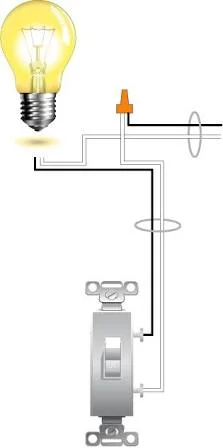

I've amended post 20 with a diagram based on yours. Do I have it right?
@DaveC426913 yes basically correct. Notice in the first diagram I posted the little circles drawn. They depict the wires going into a cable sheath or conduit. Basically the entrance/exit to the box. The one diagram you posted has a circle out in the middle of nowhere. A bit confusing but the colors are done right concerning a switch leg.
Now here's something that throws a monkey wrench into the gears concerning the terminology. Many places now it is necessary to have a neutral at the switch to power occupancy sensing switches. In the case of a switch leg we just run three conductor cable. And of course now we can continue the circuit on from there. So is it still considered a switch leg? If we chose to wire it so the source stops at the switch first we could eliminate the run with three wires and just use two. But in that case there won't be a constant hot in the ceiling and some day we might want a ceiling fan. So, best to run three wires between the switch and load and the source goes to whichever box it is convenient.
The circles are electrical boxes. One for the switch, one for the receptacle and one octagon for the split. (In your diagram you have a Marrette connector, but any connection like that would be in a box, not loose in the wall.)
The only functional difference between the two setups is that there is no split, therefore no octagon box.

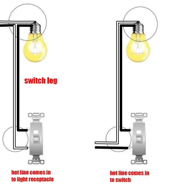

Ah, so this:
Two wiring diagrams of a light bulb controlled by a wall switch, one with the hot line entering at the light receptacle and one with it entering at the switch; red labels read switch leg and hot line comes in.
It sounds like Russ has hit on it.
You might use the first configuration if the line is nearest the light receptacle, whereas you'd use the second configuration if the line is nearest the switch.
