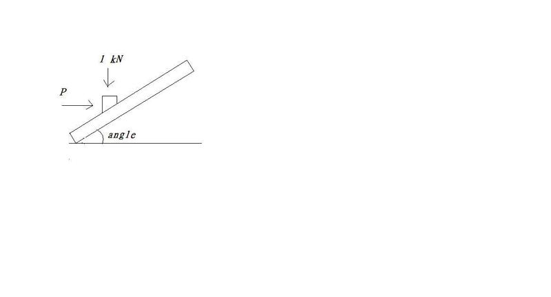

I have attached a picture. Determine the friction force acting on the block shown when the angle is 30 degrees and P=200 N.
us=0.3 (static friction)
uk=0.2 (kinetic friction)
I set up a free-body diagram w/the 1kN, P, Normal force and frictional force. I was able to solve for both the Normal force and frictional force. I got 326.79N for friction and 966.025 for Normal. I thought I was incorrect because it doesn't fit into the f<=usN

Perhaps if you showed your working, we could show you where you've gone wrong...
I would draw a better diagram :).
One with acceleration; in which direction is it pointing? Acceleration sets your positives/negatives on the axis on the diagram. The friction; in which way is friction pointing/acting?
After doing such you can do a summination of forces =).
