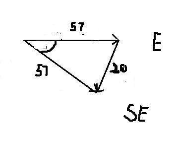

You are flying in a light airplane spotting traffic for a radio station. Your flight carries you due east above a highway. Landmarks below tell you that your speed is 57.0 m/s relative to the ground and your air speed indicator also reads 57.0 m/s. However, the nose of your airplane is pointed somewhat south of east and the station's weather person tells you that the wind is blowing with speed 20.0 m/s.
In which direction is the wind blowing? Express your answer as an angle measured east of north.

vector triangle
Hi iluvphys! :smile:
The triangle has two sides of 57 (one is due east), and one side of 20.
So the angle of the 20 side is … ? :smile:
Hello sir,
I used the cosine rule and got 20.21°
I assumed that you said one side is due east means that it looks like the vector picture i attached.
Is my answer to your question acceptable?
Thanks again for your kind help-

iluvphys said:
Hello sir,
Don't call me sir!
Yes, it's 20.21º …
though you could have got it quicker by splitting the isoceles triangle in two, to get a right-angled triangle with sides 10 and 57. :wink:
And can you now answer which direction the wind is blowing? :smile:
hmm … there's one wrong with the picture …
you haven't put the letters A G and W on …
if you don't do that, you can't be sure that the arrows are the right way round. :wink:

iluvphys said:
Hi tiny-tim,
i have spent quite some time on this problem and thanks to your help got most of it.
So is the answer to which direction the wind is blowing not 20,21?
No, 20.21º is the angle between the plane's actual speed and its speed relative to the wind.
This is why it is so important to label the triangle!
can i use the cosine again and get the angle?
Or how do I know what the angle is? Do i have to use cosine again?
Then I would get 31.54?
I have been trying for days now and I can't seem to have gotten the grip of it yet.
Could you please show me how you got your answer? I really tried figuring it out but i am almost hopeless. I have 20.2 but what do i do next?
Could the answer be 180-31.54= 148?

Finally...
The answer i was lookin for is 20.21/2.
Thank you very much for your patience. It was really absurd because i was doing all the relativity questions with ease and then there comes a problem like this... :)
