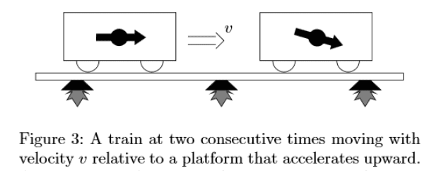

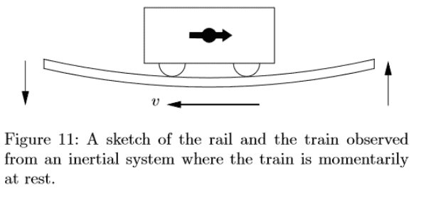

I didn't want to derail the last thread on the sliding block, but I think I noticed something interesting.
If we look at http://arxiv.org/abs/0708.2490v1
consider first the image in figure 3
and compare it to the image
in figure 11.
Ignore the wheels, which complicate matters, for the time being, and assume the block actually slides directly on the floor. In the first image, the middle of the sliding block is flush with the floor of the elevator, in the second it is above the floor, and only the two ends of the block touch the floor.
So the two diagrams are not of the same physical situation as far as the shape of the train goes.
If we assume the situation is described as figure 3, then in figure 11 the trains belly should "sag" to match the floor. The train wouldn't be "flat" in an instantaneous comoving frame.
If we assume the situation is as described in figure 11, the drawing in figure 3 would have to change. The train would have to be bent in an upside-down U shape, in order for its middle to be above the floor.
This behavior does not seem Born rigid at all. But maybe it doesn't have to be...
