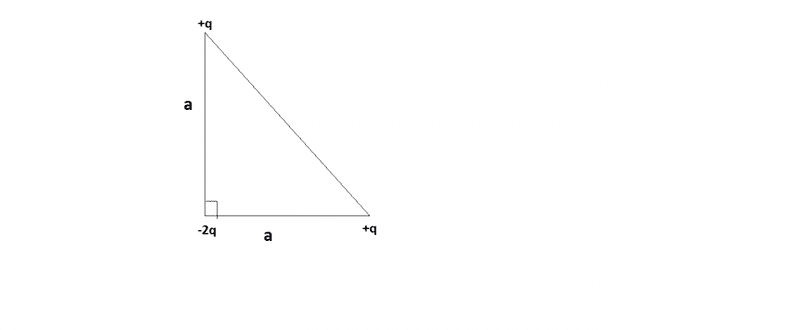

find the electric dipole moment of the system shown in figure
In the simple case of two point charges, one with charge +q and the other one with charge −q, the electric dipole moment p is:
where d is the displacement vector pointing from the negative charge to the positive charge.
I thought dipole moment would be zero because there is no dipole in the system.+2q and -q can not make a dipole because for a dipole we need two equal and opposite charges which is not the case here.+2q and +q can not make a dipole either.and +q and +q they don't fulfil the criteria so if no dipole "dipole moment "should be zero.other confusion that i am facing is whether this system is in equilibrium .or the charges can move due to repulsion/attraction.
The charges are supposed to be fixed, they can not move.

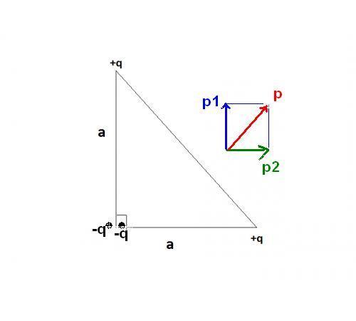

You can consider the array as if there were two -q charges at the bottom left corner, that is there are two dipoles. The dipole of the array is the resultant.
A charge distribution can be characterized by its net charge and momenta. It can have a net dipole momentum, of quadrupole momentum and so on.
Thanks.My answer came out to be qa√2
That is the magnitude of the dipole moment. But it is a vector. Write it as a vector either with its components, or give the direction.
ehild said:
give the direction.
it would be in between the two vectors at 45 degrees
It is correct.
