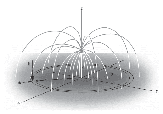

Hello, I tried to do something like this
http://imageshack.com/a/img921/9379/gQAcim.png
I also thought of doing something with the image charge
http://imageshack.com/a/img924/2415/9XBrlC.png
However, I am not sure what is the charge enclosed in this sphere...
If you included more electric field lines in your drawing (coming out of the upper part of the point charge), wouldn't some of those field lines go through the flat top of your cylindrical Gaussian surface, and also wouldn't some of the field lines go through the vertical (curved) side of the cylindrical surface? Thus, there would be some flux through your Gaussian surface that you have not accounted for.
Also, how does your picture account for the fact that you are interested in the field lines that leave the point charge in a horizontal direction?
I don't know. What I thought was that I can make the height of the cylinder even larger in order to cover those field lines you mention because it doesn't affect the result. And the horizontal field line starts bending in the instant it is coming out the charge, so... I really don't know.
There will always be some field lines that go higher than any finite height you choose for the top surface of your cylinder. The field line that leaves the point charge vertically upward will go vertically upward to infinity. Those that leave the charge almost vertically upward will go very far upward before curving back down and meeting the plane very far away from r = 0. If your cylinder has a finite radius, d, then some of the field lines will pass through the vertical side of the cylinder. So, a cylindrical shape Gaussian surface doesn't appear to be very appropriate for this problem.
Since you are interested in field lines that leave the point charge horizontally, try to picture all of the field lines that leave the charge horizontally. Can you describe roughly the geometrical shape of the surface formed by all of these lines?

Could it be a paraboloid?
Probably not a paraboloid, but it will be some sort of "dome". Can you use that dome surface as part of a closed Gaussian surface?
Well, since the field lines with the image charge resembles ellipses, I could guess that it could be half part of an ellipsoid...
The exact shape (paraboloid, ellipsoid, etc.) of the dome doesn't matter. Try to use the dome to your advantage.
