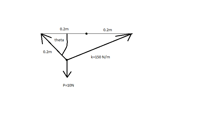

A vertical force P=10 N is applied to the ends of the 0.2 m cord AB and spring AC. If the spring has an unstretched length of 0.2 m. determine the angle theta for equilibrium. Take k = 150 N/m.
Fspring=ks
Fy=0
Fx=0
Any of my attempts at this solution have resulted in pages and pages of work. I really am not seeing a short cut as to find the angle theta.
Honestly, I cannot say this is something difficult...
You don't show any equation, any force diagrams.
How can you represent on the plane the cord and spring forces ?
