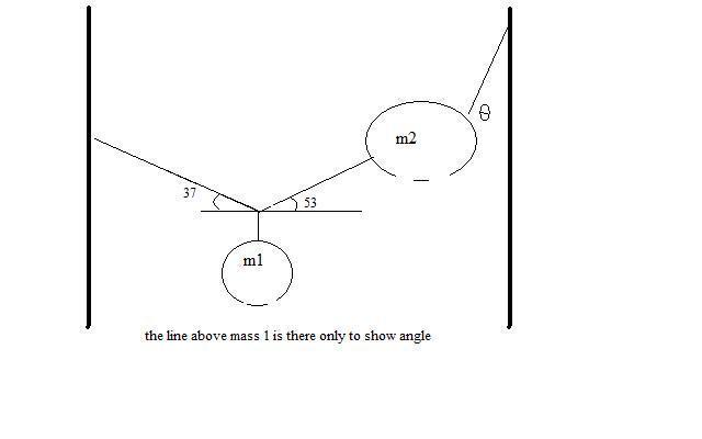

attached is drawing of diagram...
two masses m1 and m2 are attached as shown in the figure. If the system is in equilibrium, find the angle labled theta.
m1 = 35.0 kg
m2 = 65.0 kg
well...to start i drew three FBD one for the mass, one for the intersection, and one for the second mass...
for the first FBD:
Tm = m * g
for the second FBD:
Fx = T2 cos 53 - T1 cos 37 = 0
Fy = T2 sin 53 + T1 sin 37 - m1*g = 0
for the third FBD:
Fx = T3 cos (theta) - T2 cos 53 = 0
Fy = T3 sin (theta) - T2 sin 53 - m2*g = 0
so...
First:
Tm = m*g; which equals (35.0kg) ( 9.80 m/s^2) = 343N
Second:
.602 T2 - .799 T1 = 0 ; so... T1 = (.602/.799)(T2) so...
.602 T1 +.799 T2 = 343
.602[((.602)/(.799))T2 + .799 T2 = 343
.453T2 + .799T2 = 343
1.25T2 = 343
T2 = 274.4N
Third:
T3=T2(cos 53/cos (theta))
[T2(cos 53/cos (theta))] sin(theta) - T2 sin 53 = m2*g
T2 tan(theta) cos 53 = m2*g + T2 sin 53
tan(theta) = m2*g + T2 sin 53/T2 cos 53
theta = tan^-1(m2*g + T2 sin 53/T2 cos 53)
theta = 79.1?
uhmm any help? that's what i got correct me if i am wrong
