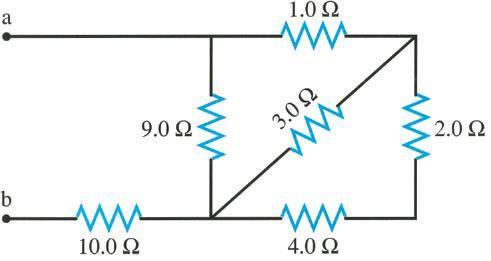

Find the equivalent resistance between points a and b in the figure
1/Req = 1/R1+1/R2... for parallel
Req= R1+R2... for series
12.63 ohms

If you show your work, we can spot your errors and guide you. Or are you just asking if your answer is right?
I have that the 4 and 2 ohm resistor are in series and add to be 6 ohms equivalent resistor. The 6 ohm resistor and the 3 ohm resistor are parallel and 1/6+1/3=1/2 or 2 ohms equivalent. I don't know what to do next though. Are the 1, 2, and 10 ohm resistors in series?
No. If two elements are in series, all the current that goes through one has to go through the other. A current flowing through the 10-ohm resistor can go through the 9-ohm resistor or the 2-ohm resistor, so the 10-ohm resistor and the 2-ohm resistor are not in series. In contrast, all of the current in the 2-ohm resistor must also go through the 1-ohm resistor, so those resistors are in series.
Try re-drawing the circuit with your new values ... it may become clearer that way. Sometimes, it helps to re-draw the circuit vertically: in your case with "a" at the top of the diagram and "b" at the bottom.
