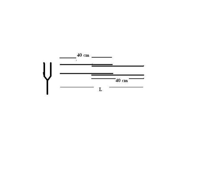

A 40 cm long tube has 40 cm long insert that can be pulled in and out. A vibrating tuning fork is held next to the tube. as the insert is slowly pulled out the sound from the tuning fork creates standing waves in the tube when the total length is 42.5 cm, 56.7 cm, and 70.9 cm. what is the frequency of the tuning fork? The air temperature is 20 degree C.
f = mv/2L
figure is attached
f = 14.2
v = 343 m/s
L =(40+40) cm = 80 cm = 0.8 m
f = mv/2L = (1*343 m/s)/2*0.8 m = 214. 375 hz
got it wrong. not sure how to do it
These values indicate that the open tube resonates at every increase of equal length of the tube. At open tube this length must be half the wave length.
