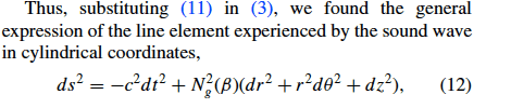

I am trying to describe sound wave propagation in the real projective space RP3. This procedure has been done for sound wave propagation on a background in a medium with the background topology of RP2 - using a line element with cylindrical coordinates. The FULL cylindrical line element is easily found.. and as shown below in the spacetime metric of an anisotropic uniaxial system in three-dimensions. I am looking for the FULL hyper-cylindrical line element --- and am having a lot of trouble finding it! just looking to see if anyone knows of it.
Signed, Mechanical engineer / Materials Science Phd student striving for a theory..
  • Equation (12): ds² = −c²dt² + N_g²(β)(dr² + r²dθ² + dz²), the line element for sound waves in cylindrical coordinates, written after a sentence referring to equation (11) in (3).
