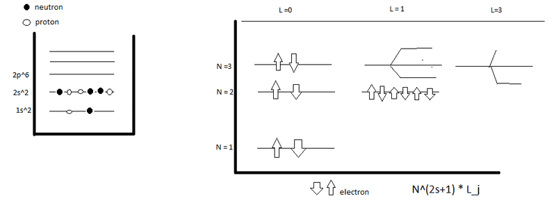

The energy changes correspond to infrared, h_bar * w.
Which particles are actually oscillating? The neutrons or the electrons?
Is it the electrons that fill up the stationary states, electronic configuration, or is it the nucleons that fill up the states?
I'm confused as to which facts of nuclear physics are separate from quantum physics? Due to strong force or something.
asking because the Legendre, laguerre polynomials or spherical harmonics and in the harmonic oscillator's case, Hermite polynomials are determined by the quantum numbers n, l and m. Are these numbers taken from the spectroscopic energy level numbers for the electronic configuration, or from the shell model?
The value of mass you put in for the oscillator is not a reduced mass.
The pictures that you have posted look like a Hydrogen atom, not a harmonic oscillator. In quantum mechanics, there is no shell model, you have orbitals that are the states with the quantum numbers [itex]n[/itex], [itex]l[/itex], [itex]m_l[/itex]. There are not really taken from any experiment, but they are needed coefficients because the polynomials and spherical harmonics have those kind of numbers.
First of all, the harmonic oscillator does not apply on the particles, but on the problem of eigenvalues and eigenstates of an harmonic oscillator potential.
You can apply it both on a neutron as well as an electron, if you choose the interacting potential to be of such a form...
In that sense, you can always work with any particle and find the eigenvalues of the energy.
There are given evaluations in introductory books of nuclear physics, in which they deal the nucleons as particles being in a harmonic oscillator potential (or with a finite well potential or or or...). As an approximation it always works, because any potential which shows a minimum, can be approximated by taylor series around that minimum as an harmonic oscillator potential ... Because of that and because it's a solvable problem, HO is one of the most important studies in QM. Things that you learn out of it, can be applied in quantum field theory etc...
But it's not giving a satisfactory answer because it also forgets a lot of other stuff.
Thank you that clears it up quite a bit.
