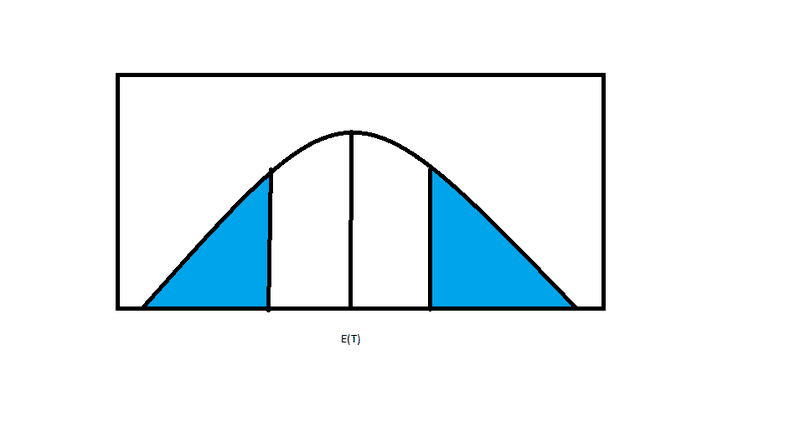

So what I could do is calculate ##P(T<5)## and go from there?
\begin{align*}
P(T<5)
&\leq P(T<5 \text{ and } T>10)\\
&= P(|T-\mu| >= 2.5)\\
&\leq \frac{\sigma^2}{2.5^2}\\
&=\frac{0.41^2}{2.5^2}\\
&= 0.026896
\end{align*}
But then I'm stuck with the shaded area shaded blue in this picture:
and I need the one in the middle. At least that's my understanding.
