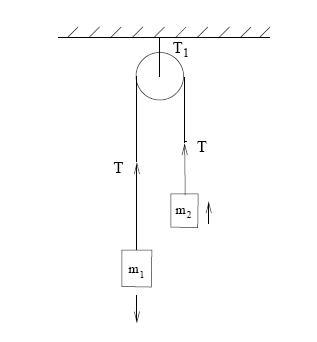

If mass 1 is 5 kg, and mass 2 is 3 kg, what is the magnitude of tension in the string supporting the pulley, T1?
The answer is 74 N.
What I presume they did was to find tension in the string and then double that to get ~74 Newtons.
My question is: why isn't T1 simply the weight of the two blocks?
The answer is 74 N.
Yes, using a FBD of the pulley in equilibrium.
It would be if the system was in equilibrium. Is it??
O.k. I think I see what you are saying. Thank you
