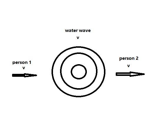

Imagine a water wave source, and its wavefront speed is v. Then one person(person 1) approaches it from the left with a velocity v.
Another person(person 2) leaves it away on the right side with a velocity v.
So the person 1 will measure both the wave front speed and the phase velocity v+v = 2v.
The person 2 will measure a wave front speed v-v = 0.
But what will the person 2 measure the phase velocity?
Except that it is not.
The speed of every individual portion of the wavefront relative to the medium is v. If one were to measure the speed of the various portions of the wavefront from a different frame of reference then that speed would vary around the periphery of the front.
But what will the person 2 measure the phase velocity? Surely it is not 0, I think he will get the same wavelength and same time of period, so the phase velocity is v. Am I wrong?
Why not? If the person sees that he is keeping pace with a region of maximum pressure (for a sound wave) or maximum ripple height (for a water wave), surely he will measure the velocity of that phase as zero.
If you have him measuring wave length divided by period then since the period is Doppler shifted to infinity, that quotient will be zero also.
Yes. Use the formula I posted. What does it tell you?

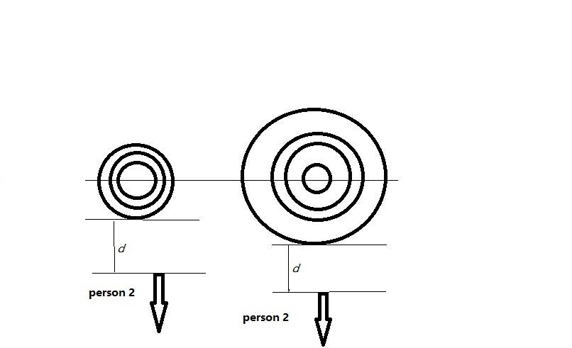

The person 2 will measure the wave front speed as zero. But how could he regard the phase velocity as 0 while he saw and knew that wave is propagating as concentric circles? Shouldn't the phase velocity be of some particular value other than zero? (Shouldn't he regard so?)
  • #46
Remember that the source is moving in this person's frame. Naively, it's quite surprising that you get concentric circles since the successive wavecrests were not emitted from the same place.
But it turns out that the phase velocity, as measured in this frame, varies with direction - from zero to 2v. And it does it in such a way that the wavefronts remain circular and centred on an object at rest with respect to the medium.

View attachment 258515The person 2 will measure the wave front speed as zero. But how could he regard the phase velocity as 0 while he saw and knew that wave is propagating as concentric circles? Shouldn't the phase velocity be of some particular value other than zero? (Shouldn't he regard so?)
The center of the circle is moving. Have you never thrown a stone into a flowing river?
Or consider surfing on a standing wave. https://en.wikipedia.org/wiki/River_surfing The phase velocity of a standing wave is manifestly zero.

I draw the image using the Earth as reference frame. The center of the circle is moving relative to person 2, while it is fixed on the earth.
