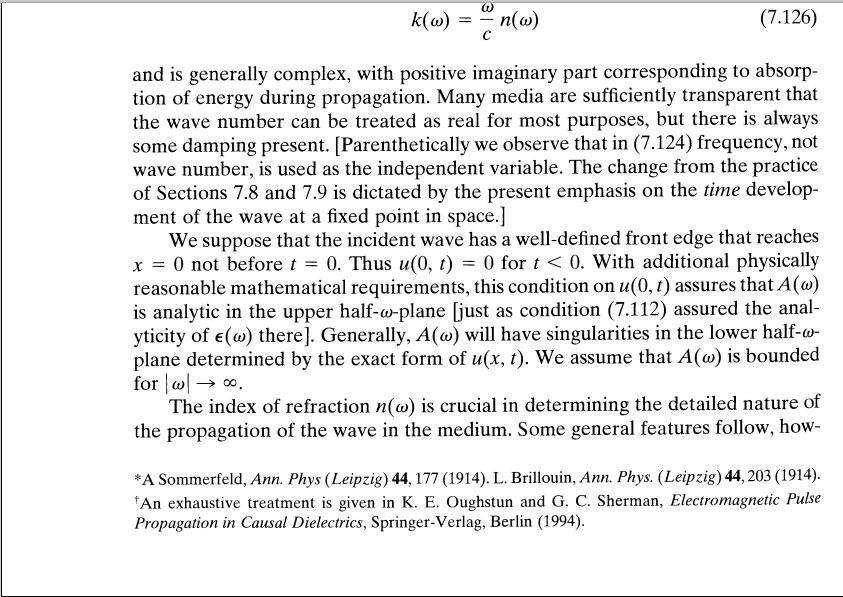

I looked up Sommerfeld's book(vol.IV Optics) section 22(pp 114) titled "Phase velocity, signal velocity, Group velocity".
I looked up Jackson's book 3rd ed. section 7.8 titled "Superposition of waves in one dimension; Group velocity".
Yes, that's the right section.
Here it's particularly Sect. 7.10 ff.

I found in Sect 7.11 it is talked about:
