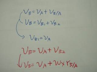

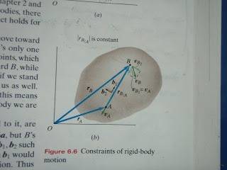

Hi I have learned Dynamics in school;;;
I have problem in relative motion chapter[rigid body & fixed position]
upload some picture.
first picture is my textbook page. In picture. textbook says to me that V(b1)=V(A)
because this particle is rigid body and point doesn't change their position each other on surface. So their moving is just rotating.
and second picture say that meaning of relative motion equation in rigid body.
My question :::::
why did't textbook say V(A)=V(b1)+some element heading to V(b2) ?
In my think it is possible V(A) has some element about b(2) axis (first picture)
but in my textbook V(A) has only b(1) direction. It make me crazy.
help me~~~~~~~~``

VB/A (the velocity of B relative to A) must be perpendicular to AB
this is because AB2 is constant, ie AB.AB = constant, so AB.d(AB)/dt = 0, ie AB.VB/A = 0
AB lies entirely along b1 (this is how unit vector b1 is defined), so VB/A lies entirely along b2 :wink:
thank you for your help
I never know (d/dt)AB^2=0 .
you're genious!
