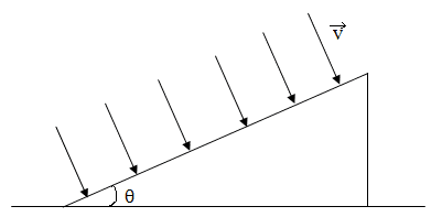

Air of density ρ, moving with velocity v strikes normally on an inclined surface (having area A) of a wedge of mass m kept on a horizontal surface. Collisions are perfectly elastic (No loss of kinetic energy). Minimum coefficient of static friction between wedge and the horizontal surface, for the wedge to be stationary, is[/B]
Force imparted to the wedge=ρ*A*v^2
Forces exerted are broken down into their respective components[/B]
Breaking down the force (exerted by the air collisions)on the wedge into components we get,
ρ*A*v^2costheta + mg= N(the normal force exerted by the ground surface on the wedge)
Here i assumed that the wedge will be in equilibrium in the y-direction
and in the x-direction(after drawing the f.b.d of the wedge),one can see that
ρ*A*v^2sintheta - ffriction = m*a(here a is zero since in the question it says so)
Force imparted to the wedge=ρ*A*v^2[/B]
Is it right?
imagine a particle of mass m and velocity v collides into the wedge elastically. What is the velocity of the particle after the the collision? How much is the change of its momentum?

UchihaClan13 said:
I don't know,for sure
And as for your second question,the particle which strikes the wedge elastically with a velocity v would rebound back with the same velocity v.
hence the change in momentum would be Pfinal - Pinitial = -mv-mv=-2mv or 2mv in the opposite direction
Yes, you have to take the total change of momentum of the air flow which is twice the original momentum. During the collision, which is very short time for an individual air molecules, gravity plays no role.
The momentum imparted to the wedge in unit tine is equal the force exerted on it by the flow of air molecules. You need to take the vertical component of this force in addition to the weight of the wedge to calculate the normal force, as you did it in the OP.

Let me write it down again(This time correctly:smile:)
Mass of air falling per second on the wedge=ρ*A*v (in 1 second,this much mass falls)
Hence momentum of the mass of air =ρ*A*v^2
final mometum of the mass of air after an elastic collision =- ρ*A*v^2 (as it's in the opposite direction)
therefore change in momentum in 1 second=-2ρ*A*v^2
therefore force imparted by the air on the wedgeρ*A*v^2
elementary vector resolutions and algebraic manipulations yield μ2ρ*A*v^2sinθ/(mg + ρ*A*v^2cosθ)
which is the correct answer
thanks againo_O:biggrin:

Here i considered the mass flow rate as mass per second
and calculated the change of momentum in 1 second
hence my time factor "t" is 1 second
I neglected the time of an individual collision since it's negligible
Is my reasoning correct?
It was correct, only the force exerted by the air flow was wrong.
