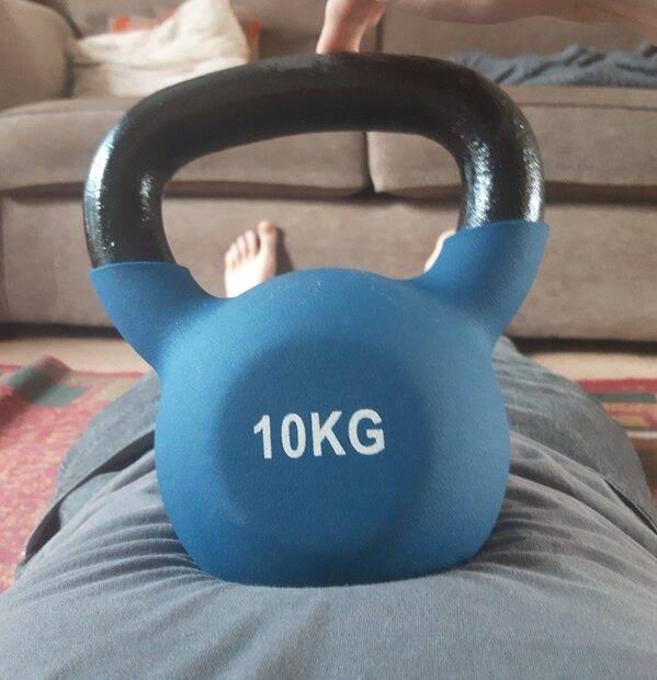

  • #84
Why putting a rock of 60 kg on my back while I am lying on belly will give immediate extreme pressure that might break the chest but lying with human body mass 60 kg will cause small pressure that a human can lie for days ? The body and the rock are of the same weight. The mass of the rock has the same human shape so that the pressure by the rock on the back will be equivalent to the pressure by the human body on the back.

Yahya Sharif said:
Why putting a rock of 60 kg on my back while I am lying on belly will give immediate extreme pressure that might break the chest but lying on back with human body mass 60 kg will cause small pressure that a human can lie for days even though the body and the rock are of the same mass?
I think you are over estimating how much pressure a 60kg rock 2m long and say 50cm wide will exert. It's 600Pa, which is about the same as water pressure at a depth of 6cm - easily survivable. The rock would be between one and two centimeters thick, depending on what rock you have in mind.
Of course the top surface of a supine human is not flat and some points will suffer a higher pressure, so I'd expect it to be uncomfortable (rather like lying face down on flat concrete is, in fact) but hardly fatal.

Ibix said:
You are missing the point of both @russ_watters' comment and mine. The point is that your sensation of how hard or painful it is to do something is a terrible guide to how much force is needed.
Damage. Damage measures the severity of pressure on the human. Compare putting a protrusion of 18 cm width 18 cm length of a rock of 60 kg on belly vs lying on a concrete protrusion of 18 cm width 18 cm length on belly and my rest of the body is on air.
In case of human you will feel some pain but in the case of a rock the rock will damage the belly completely.
  • #89
Yahya Sharif said:
But 101325 N/m^2 is a rock of 10132.5 kg on the human body of 2 m length and 50 cm width so a mass of 10 tonnes is on the human body will crush all human body bones.
You can not make that rock have 1 m2 contact on the human so the pressure will be much larger.
Humans can be buried in sand which are tiny tiny rocks. But the weight of the sand is more evenly distributed along the human body thus increasing the area of contact.
Eh, no it won't crush your belly...
  • #90
Yahya Sharif said:
do not know
And this is the problem. You are guessing instead of calculating. Of course, you cannot calculate because you have no model except your own personal incredulity that human bodies obey the laws of physics.
Yahya Sharif said:
there is a different between the pressure under water and the pressure of a mass on body.
There is. It's that water pressure is isotropic (more or less) and the rock isn't. Nevertheless, it's worth comparing your rock to water. If I put a child's paddling pool on you and filled it to a depth of 6cm, do you think it would hurt? If I put a 60kg 2m×0.5m rock on you do you think it would hurt? You've already answered yes to the second question, and you now know the paddling pool weighs the same. But what's your instinctive response to the paddling pool? I bet it's not "that would destroy me" - but if your instincts are a consistent physical model then they should tell you the paddling pool with 6cm of water will crush you the same as the rock.
Of course, neither will crush you.
Yahya Sharif said:
At 10 meters under water the pressure on the body is 1 atmosphere which equivalent to 101325 pascal
And I expect a "paddling pool" ten meters high filled with water and placed on your chest would crush you, yes.
Yahya Sharif said:
Compare putting a protrusion of 18 cm with 18 cm length of a rock of 60 kg on belly vs lying on a concrete protrusion of 18 cm width 18 cm length on belly and my rest of the body is on air.
Nonsense. Go to YouTube and search for "weightlifting fails". The site is awash with videos of idiots benchpressing too much without a spotter and ending up trapped under their barbells' bars. That easily provides pressures well above your 18×18 rock example, even if you neglect the initial extra pressure from stopping the weights' fall. It doesn't look comfortable, and I bet they have impressive bruising, but they're not cut in half.
