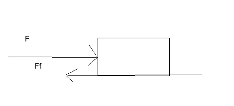

If frictional force in system (say a block being pushed on a horizontal surface) is less than or equal to us*N then there is no slipping. Why is it that if the frictional force (Ff) in the system is greater than us*N then there is slipping (I am finding it hard to wrap my head around this)? us is coefficient of static friction and N is normal force.

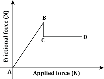

Because the bonds between the two materials are breaking. Note that the dynamic friction force drops as soon as the threshold force is reached.
Imagine the parts glued together and then you break the bond; one part can now move with respect to the other.

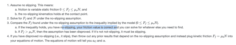

According to my notes if the frictional force <= us*N, then no slipping occurs, but if frictional force > us*N then there is slipping?
My notes say this, specifically what does part 3b mean? If Ff > us*N why are we now slipping because isn't the Ff < us*N if Ff = uk*N?

  1. If there is slipping, the friction force is ##\mu_kN##;
  2. If there is no slipping, the friction force may be anything between zero and ##\mu_sN##;
  3. If there is no slipping and the force exceeds ##\mu_sN##, slipping occurs (thus going to condition 1, i.e. ##F_f = \mu_kN##, and this is as long as there is slipping).

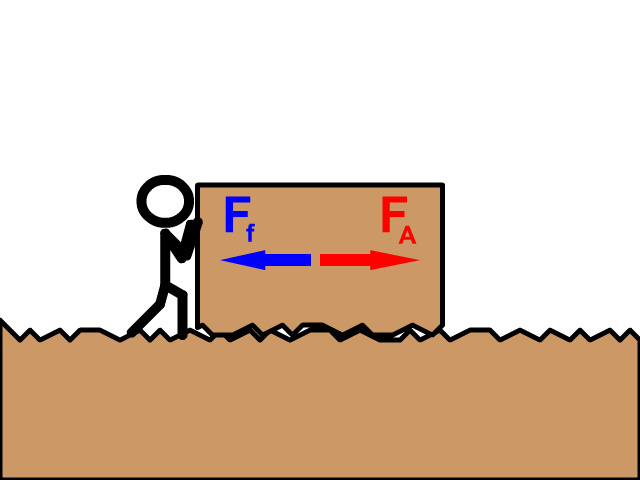

You can feel this by pushing an object sitting on another object. While increasing the force slowly, the object doesn't move. Once you reach the threshold force, the block suddenly starts to move and the block becomes easier to push (i.e. less force required).

My point was more about how you are thinking about the forces.
The frictional force opposes the applied force to the object. So for a static object, the object does not slide until the applied horizontal force exceeds ##\mu_s N##. To state that in terms of only the frictional force being less than ##\mu_s N## seems to me to miss an important part of the force balance situation.
The frictional force is the result of the external force applied to the object; it does not exist all by itself.

That value is a threshold between static and kinematic types of friction.
Please, see:
http://hyperphysics.phy-astr.gsu.edu/hbase/frict2.html
